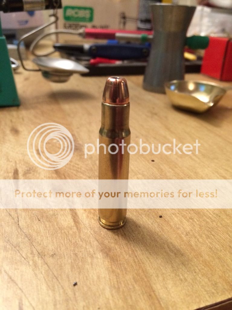

.357 pistol bullets work great for plinking loads in the .358 Winchester. Mine is a stainless laminate BLR takedown. I use Blue Dot with Hornady 158gr XTP bullets and get a muzzle speed around 1500 fps with respectable accuracy. Check out Speer Reloading Manual No.12 for higher speed loads with pistol bullets in the .358 Win.
