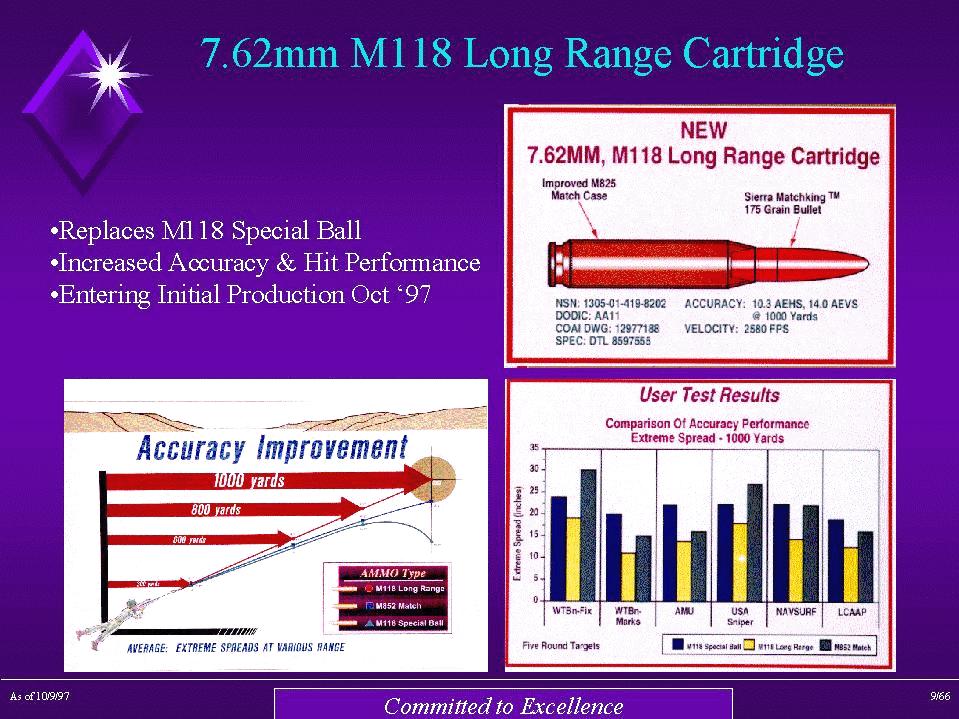

I shoot 168 SMK's and love em. I dont intend to shoot past 600 yards with them though. I tried to duplicate the M852 military round.
The 168's were the cats meow back in the day, but for 700+ yards, everyone is right - the 175's function better.
However, up to 600 yards, they preform near identical. So, if you intend to shoot up to 600 yards, buy whatever is cheaper. If 700+ grab the better performers!
Just my 2 cents.
PS- here is one of the documents i have stashed away in my .308 archive. It shows the M118LR (which I believe has the 175 grain bullet) shows better performance past 700 yards.
