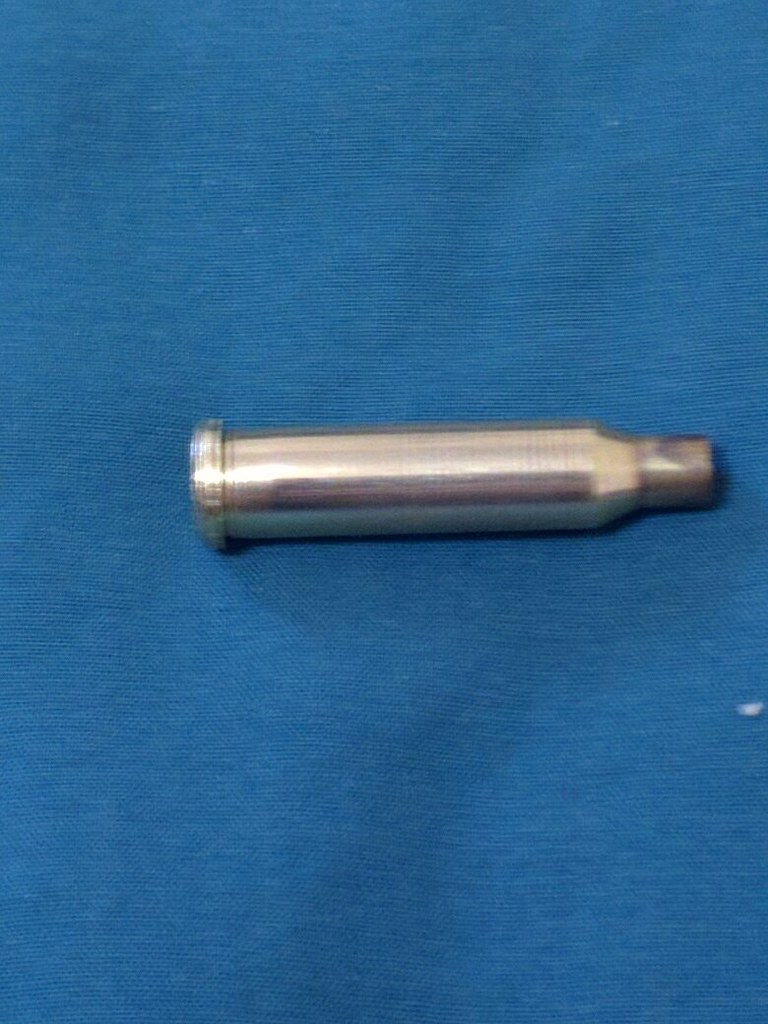

I kept an eye on the growth of the case neck after each shot. The case after 27 shots (I repeated a few due to other factors) had grown from 1.345" to 1.362". The primer pockets were still fairly tight. The brass had a reasonable amount of neck tension with out annealing it and wasn't showing signs of cracking, although it was probably hardened somewhat as it was seeming to be springing back when pulled out of the sizing die. I think that with an annealing and a trim, this case will still have a useful life.

At 13.3-13.5 gr, it had a perfect sine wave pattern that went from the neck to the very edge of the shoulder. It got lopsided at 13.6 to 14 gr of powder. One side wasn't coming back up as high as the other. At 14 gr, the pattern became more symmetrical, and by 14.2, it was almost symmetrical again...

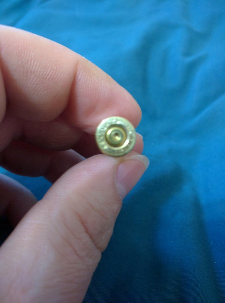

I've actually experienced quite the opposite of premature pressure signs. Bolt lift resistance decreases dramatically, while brass life increased by at least 3X so far. I'm still using that brass. Maybe it depends on the type of lube. I could see that sticky oil that RCBS or Lyman sell causing problems... That stuff was thick like grease, and not very slick. That is literally the only thing I can think of... I haven't used normal case lube for years. I'd like to try white graphite as soon as I can get some.

I have not had any of those kinds of issues. No rubbing on case heads. Bolt lift is easier.
Here are pics of the 27x fired case. Pics are the best I could do. But as you can see, the case is not showing pressure signs. The primer is showing the pressure from the last 14.2 gr load. It is barely flattening from new.
