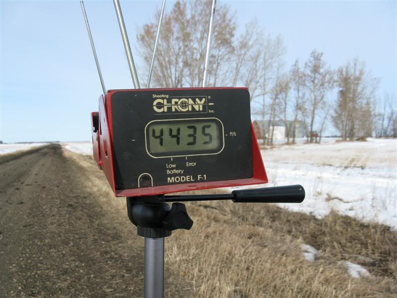

I was doing some load development with mine and had the 20gr V-Max zipping along pretty fast. I backed them off to just over 4000fps. I was shooting into the ditch on the right and it's a field road with no traffic. The camera angle makes it look bad.
