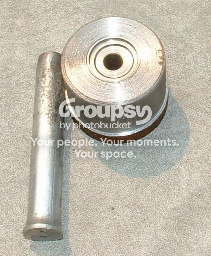

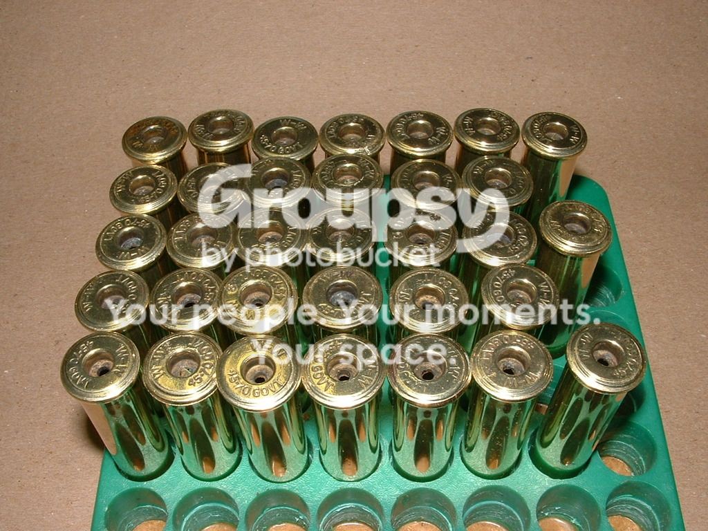

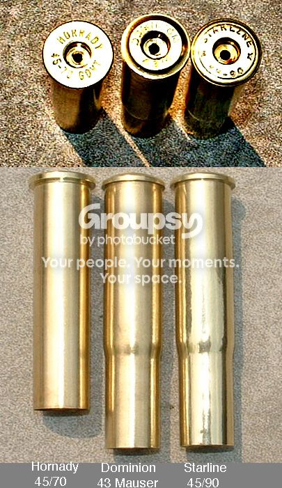

To make the A-base on 45/70 or 45/90 brass one has to construct a little die and punch to push the rim up. See picture #1. This little die was constructed on a lathe but one could make something like this by soldering two washers onto a steel plate. I use a hammer and work on a case until it looks even. In picture #2 we have three cases. An unconverted 45/70 case, a Dominion 43 Mauser case, and a 45/90 case that has its rim raised up with the little die. We are trying to emulate the 43 Mauser case. Raising the outer rim of the 45/70 or 45/90 case does two things. It increases the head space and it allows the extractor to ride over the case as it was designed to do.

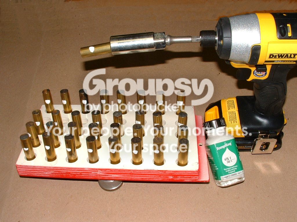

Next, the cases are annealed. The mouth of the case is rotated in the flame until the Tempilaq melts. It's then dumped into water. The cases are then cleaned to remove the Tempilaq.

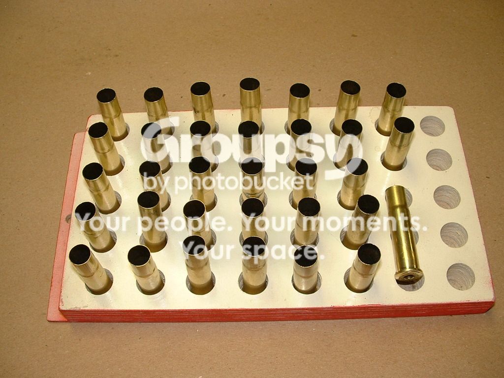

Here are the cleaned cases with the freshly made A-Bases showing.
The cases were lubed and run through the Lee 43 Mauser die to form the neck. This was a smooth one-step operation.
The cases are ready to be loaded and fire-formed by my buddy. It will usually take two firings to fully form the case.
