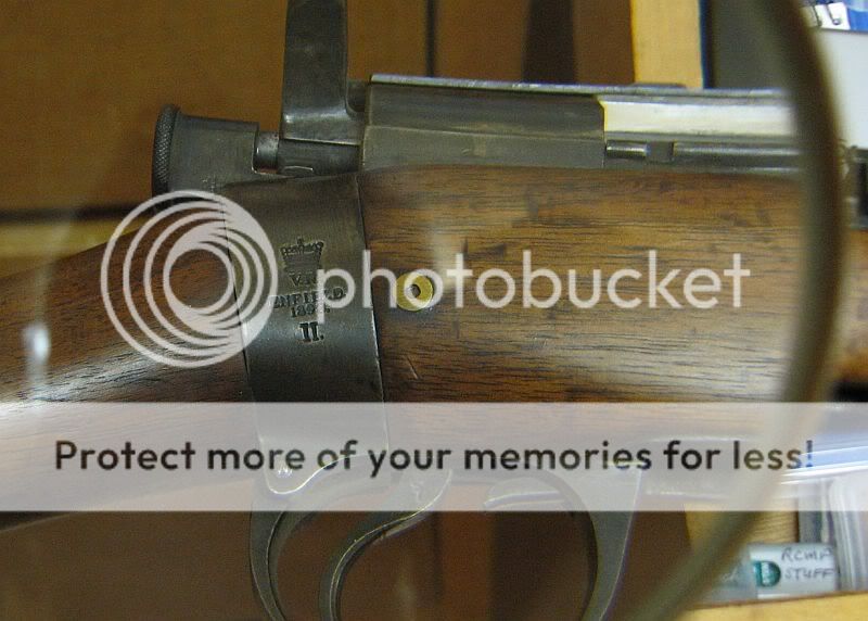

I have a Lee-? dated 1893 on the wrist socket. I posted pics a while back, but don't recall if it was determined to be a Metford or an Enfield. It has a magazine cut-off, and no safety. Unfortunately, Bubba got to it before I did.:redface:

The original Lee Metford Mark II with a 1893 date did not have a safety catch. Metford rifling is 7 groove while Enfield rifling is 5 groove.
If the barrel was changed to an Enfield barrel, it would have been marked with an E on the Knox form and the butt socket marked with the modification.
I am not sure what all the markings are on the Knox form, but are unlike anything I have seen before....possibly personalized? The three lines crossed are a sale mark to show that the rifle was sold by the Crown.
The wrist socket markings denote that it did indeed start out as a Mk.II Lee Metford. The barrel is an old civvy replacement, the marking on the Nock's form flat is that of a Scottish thistle trade mark. I don't remember which gunsmith that was off hand, but I'll go dig in my notes.

It does, indeed, have a different barrel, marked "Alex Martin, Glasgow 4347".

Thanks for the info. It is an interesting old rifle. Not so badly Bubba'd as I initially thought.
