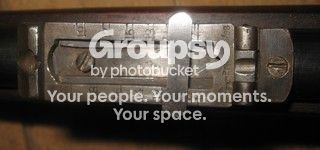

First fit up. I installed a bolt and fired it into the backstop. It cycles beautifully.
Now to work on the sights.
