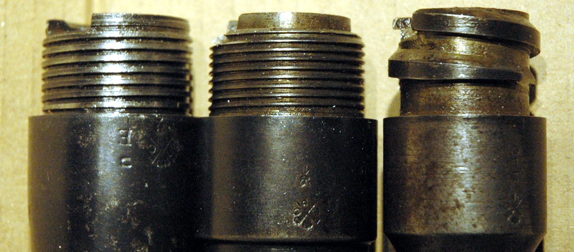

It is possible to cut 1905 pattern threads on a barrel. A member here has done it. But it sure isn't easy. Not many lathes can cut 3tpi.
Or are you thinking of using the stump of the original barrel as a bushing, and threading the .44 barrel into that? There isn't a whole lot of steel between the root diameter of the threads and the shank of the new barrel, but should be do-able.
If the rifle is a sported II** target rifle, the threads will be conventional square pattern.

The Mk. II** has square threads. The other Mk. II rifles have the modified buttress threads.
Left side - Mk III with square threads
Centre - Mk II** with buttress threads. The vertical front face can be seen in the pic.
Right side - Mk II*** with 3TPI left hand modified buttress thread. Some might call it a modified square thread, but I agree with tiriaq's description.
B-noser - Thanks for the clarification. Either the Mk. III or Mk. II** threads would be easier to cut than the unique left hands 3tpi threads on all other Mk. II barrels.
Note the root diameter of the MK. II shank. If the barrel shank is to be converted into a bushing, and internally threaded for a new barrel, the new barrel's shank diameter will be quite small.
