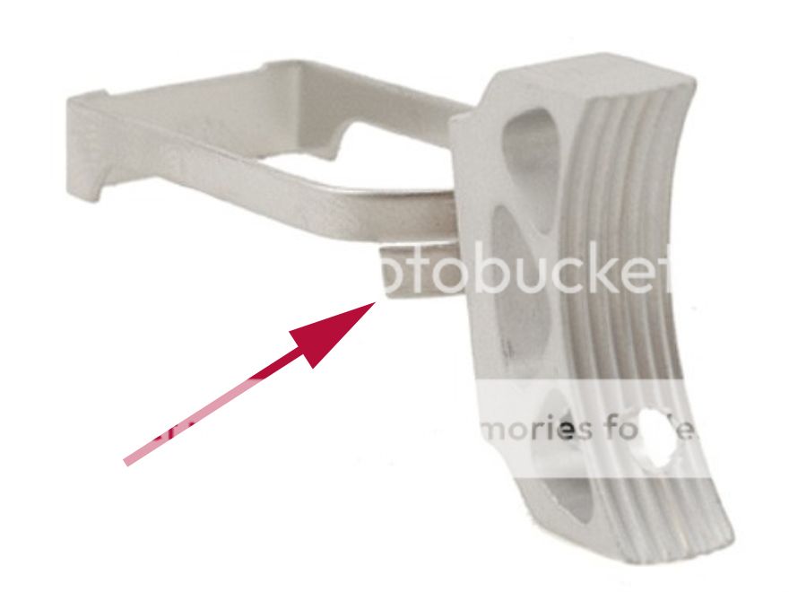

you will have to bend the little tabs at the front of the trigger to let more space.
you can do it either by pushing the bow so they bend on the frame or remove the trigger and bend them manually
