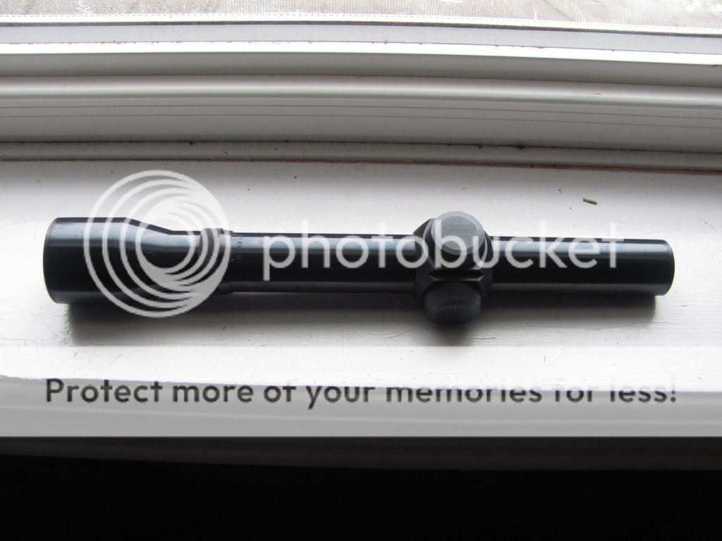

I got a really nice old Weaver K-3 scope from a friend this summer. It was lying around his shop, filthy and unappreciated, but it was in nice shape. I brought it home and cleaned it up.

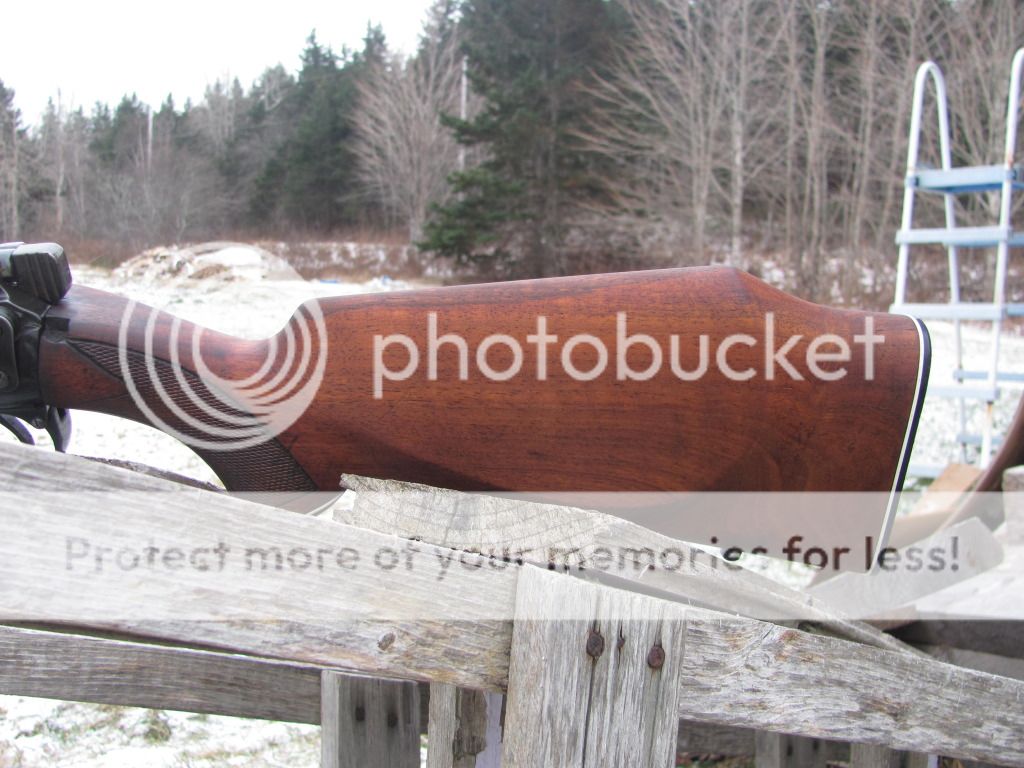

I brought it home, tore it apart, and refinished the stock...monday. What can I say, I was motivated. I watched the kids play outside while I sanded. Doh! Forgot before pics. Let's just say it looked like someone sanded it with a grinder and slapped some tung oil on it. Most of the finish was worn off. I sanded it smooth and after much thought decided to BLO it. I used to be a shiny guy, but the BLO has grown on me. I also cleaned the metal up a little.

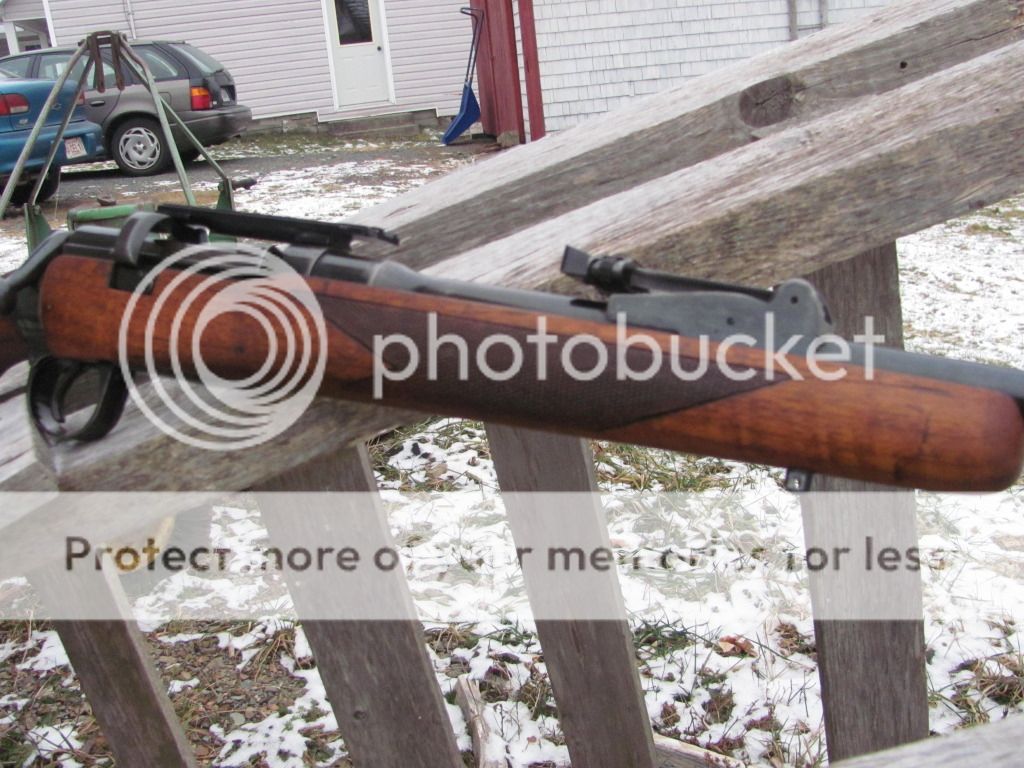

This is an after shot.
It turned out well. Very nice walnut on both a fore end and the butt.

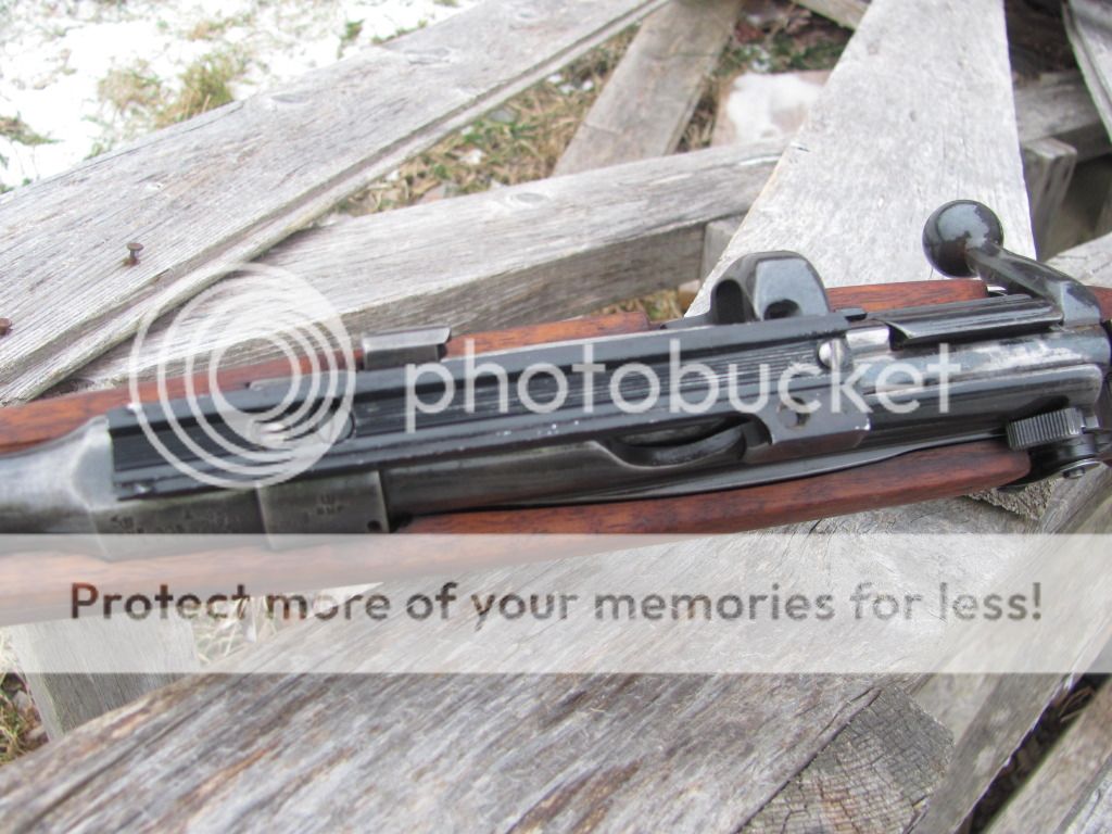

One issue is that the D&T job sucks. I figure the holes became stripped so they had to be drilled out and tapped larger, and to make room for the larger screws the rail had to be drilled out too, so no changes can easily be made here.

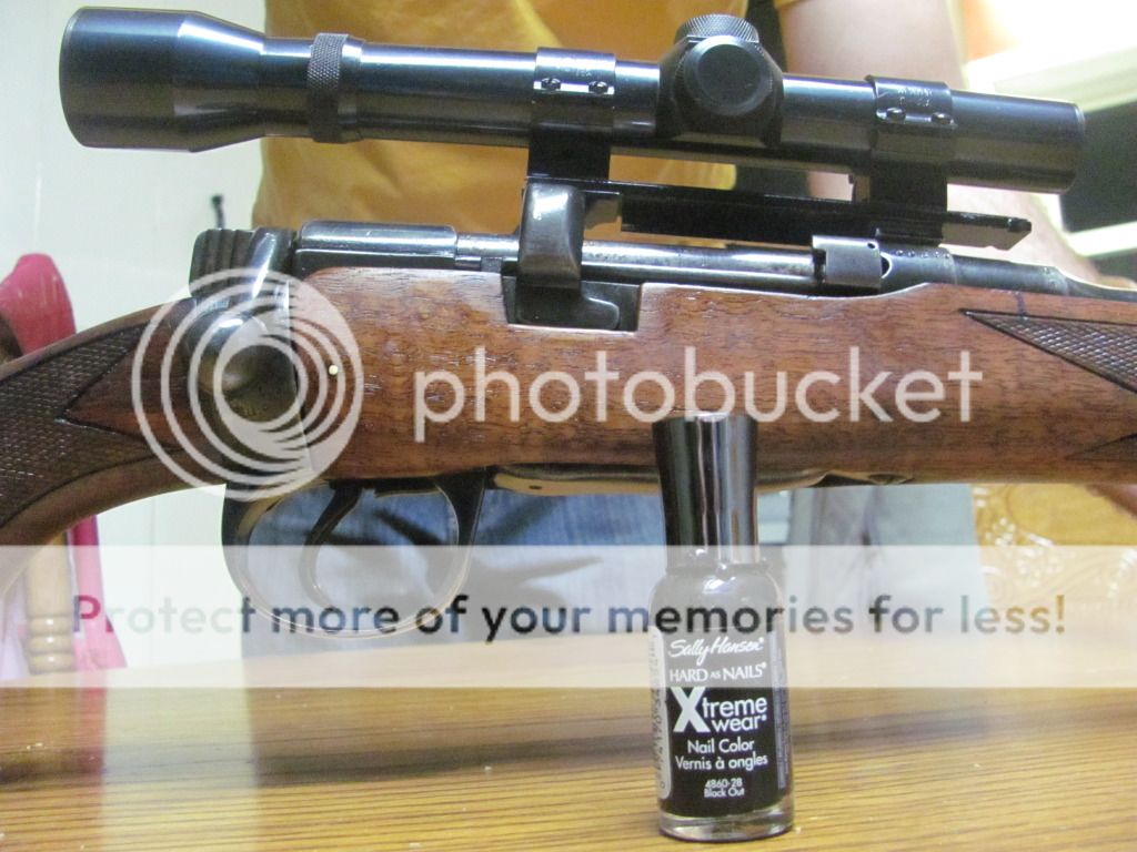

When you bolt those rings down, be sure to put a little dab of NAIL POLISH on the rail, just where the ring clamps on. This should help prevent the rings from moving backwards when you let go a round: the .303 has enough recoil to do that.
That is one of the reasons that this mount wasn't all that popular, although it was a lot better than nothing.

Here is a pic for smellie...this is the toughest looking nail polish I could find. :D

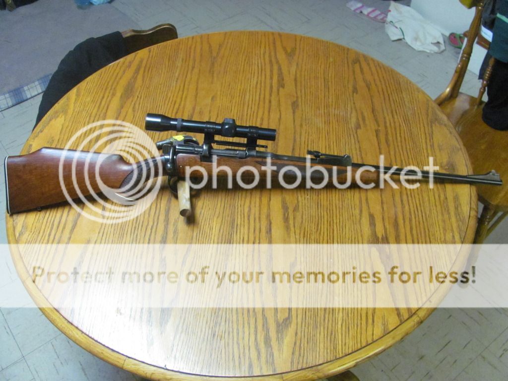

Here is a shot of the whole rifle. I bolted the rings right above the screws for the mount cause I thought it would be strongest. The scope is located so that when I pop the rifle to my shoulder the scope is placed at just the right eye relief. I accomplished this by raising it to my shoulder with my eyes closed and my head in a natural position and then opening my eyes and seeing what the sight picture looked like and adjusting it accordingly. I dunno if this is correct, but it works for me.
Now to the range. If it shoots 3" or less at 100 it will be my bush gun next year. For the stand and those evening hunts when brightness of scope is critical I'll still resort back to my tried and true BLR with the Leupold 3X9X40.
