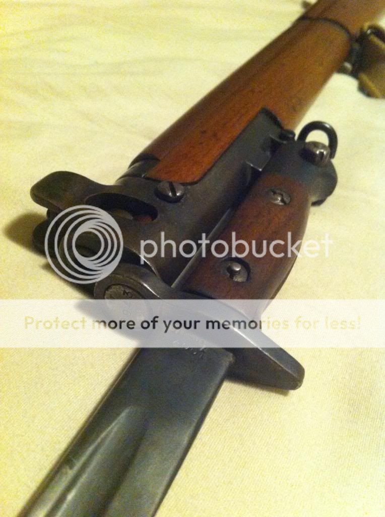

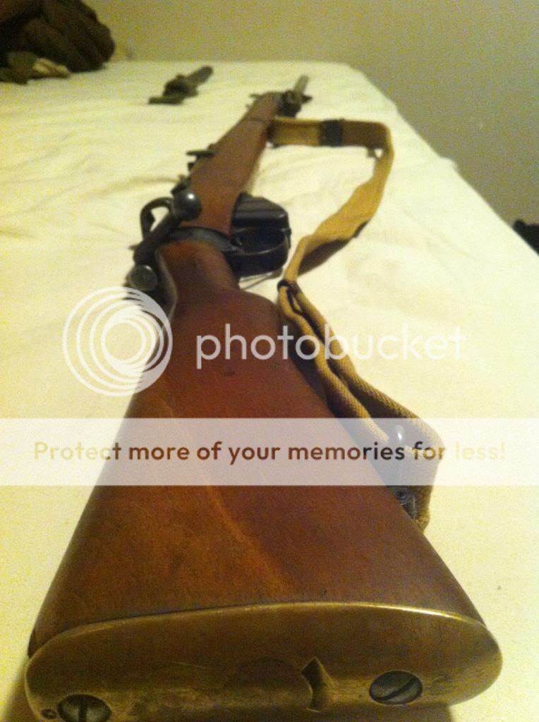

It's a beautifull rifle. It does appear to be a rebuild. That is defenitely a #4 butt and butt plate. I think with the bayo it is getting close to 500 but only just. If I bought it I would change the butt stock and plate. I have a few so pm me if you buy it

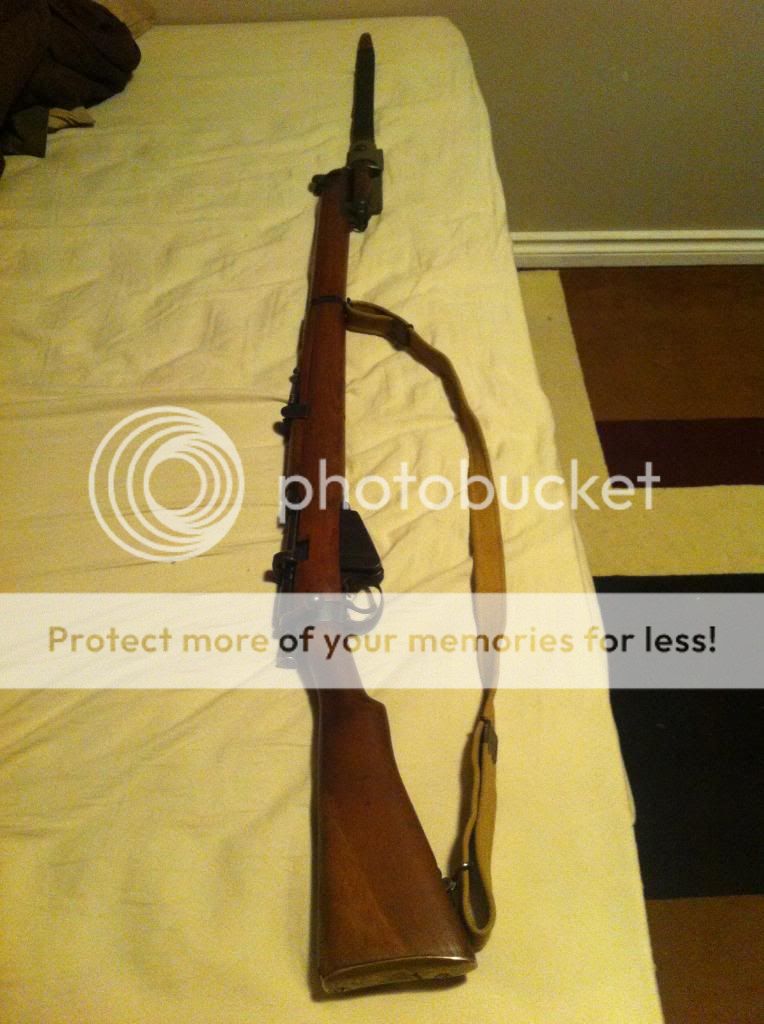

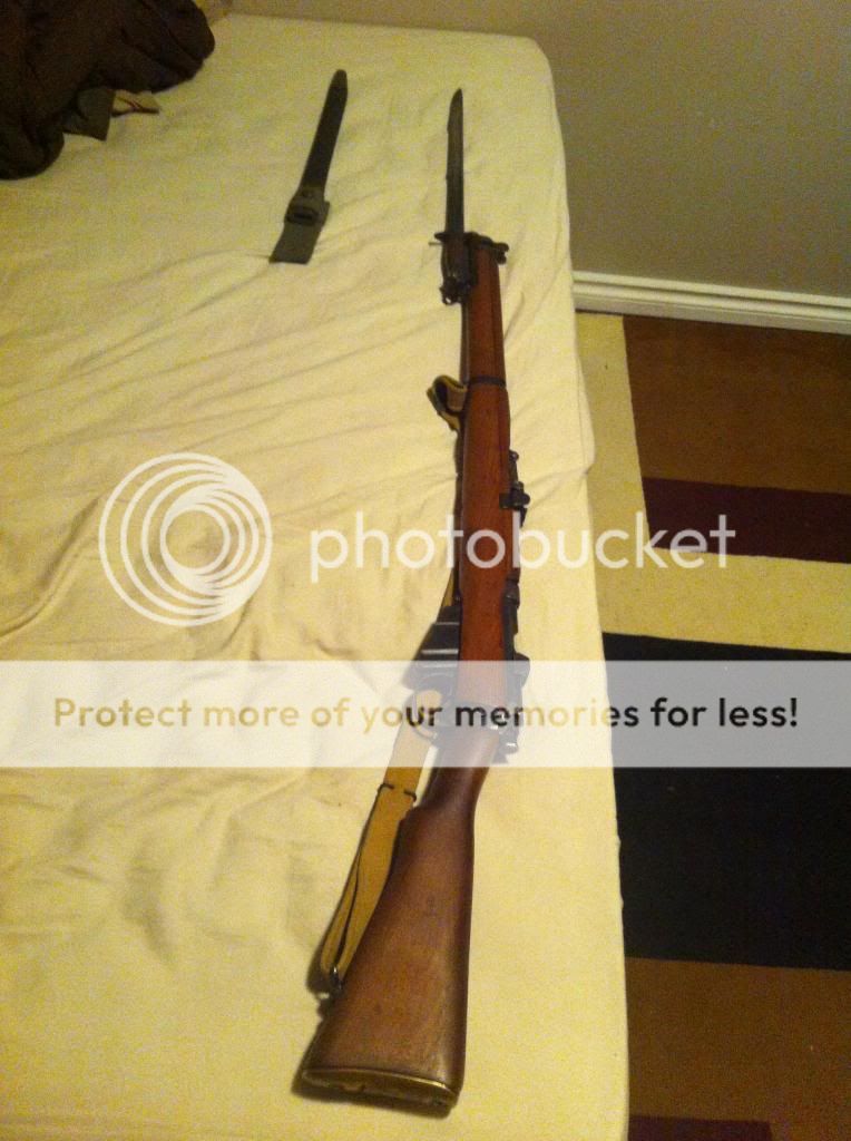

can someone show me how this butt stock was never on a model 1918 B.S.A? most of the ones ive seen share the same design and brass plate, also in my hands the wood grain even matches im not trying to say i cant be wrong but this really does look to have been on rifle since its day one and the pics ive seen of other rifles show the same stock even videos and when i see this safity notch it looks like its been added on after the fact.........the rest of the rifle being clean cuts and these notches look as if there hacked in almost like it was an after thought due to a bit of a production rush maybe this one was crated before any one fixed it ive also been seeing other rifles with out the disk fill......i would just like some proof of a miss match if nothing else for my education
So after some searching.....im finding some rifles with out the disk and brass butt plates, why do some not have a disk
like these and by the same logic these are wrong? these but stocks dont match there rifles?
No1 on left, No4 on right, the main difference is the butt trap.
Note difference between relief cuts for the safety catch.
Link to my 1918 BSA MkIII* this one appears to be "as original" as you can hope to find & the No1 used for the above photos.
http://www.canadiangunnutz.com/forum/showthread.php/933181-1918-BSA-MkIII*-SMLE
As for Piling swivels, they weren't deleted until 1941 so your rifle may have had one fitted for its entire service.
so now the disk......i would really like some info on why on some you see them and some ya just dont?
