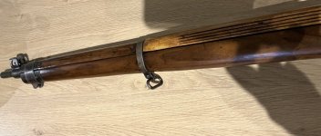

Just because it has a reinforcing screw through the fore end does not automatically mean Ishapore. The Brits did it to. The Brit ones are done much more neatly and do not go right through to emerge on the other side.
Ishy screw are much cruder with larger and usually burred heads and they go right through to emerge on the other side and then filed flush.
Its a popular misconception that screw = Ishy but this is not always the case.
I've seen this stated many times on Gunboards Enfield forum but have yet to see anyone show an actual example of an English installed Ishapore screw. I suspect the English approach was typically to just bin the forend if cracked and strongly doubt they ever installed them as a preventative measure as the Indians did. Frankly, every LE No. 1 and No. 4 should have a reinforcing screw in that location as it will save a forend if the draws area goes bad and it is shot. Peter Laidler's advice (on milsurps forum) that the screw should be replaced with a wooden dowel is quite ridiculous.
milsurpo
I’ve never seen a Brit ishy screw myself, having handled hundreds of Enfields.
There are two grades of Indian installed screws, factory and field armorer. The factory ones are much neater and date to manufacture.
Virtually all the ones in no.4 rifles are field installs and crude.
