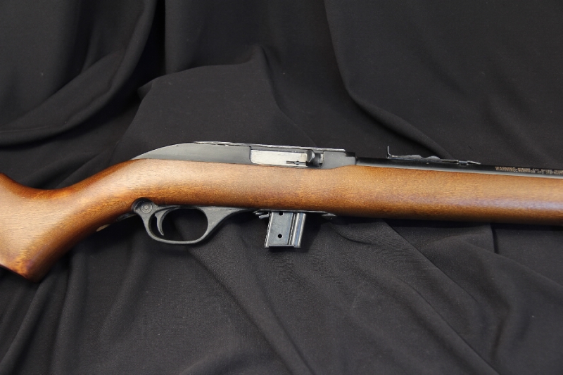

similar to older marlin 1022 looking like a newer ruger 10/22

I haven't seen a Marlin 1022. Do you have one?
yes i do.. Its actually called a 70HC. (my bad) but its the forerunner to the 10/22 If I recall correctly.
All this brand swapping reminds me of the Ford/mazda and Dodge /Hunyday/ mitsubishi cross overs that were everywhere in the late 90's early 2k's. Might still be that way. I dont know. dont care really. just sayin'
but yeah Marlin 70HC is the new 10/22
I may have this wrong.. I do know that this marlin is a near identical match to another semi auto 22 o there. I figured it was the 10/22. I bought this gun new in kamloops back in the early 90's. shortly thereafter it was discontinued a marlin no longer offered it. It was then offered by another gun co. and the two were very very similar and a magazine from one fit into the other. Even the bullets would interchange! LoL!!
