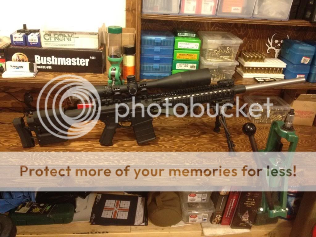

Hey all, thought I'd share a pic of my 1st AR and send a broad thank you to everyone who took the time to help a noob out!
This was by far one of the coolest projects I've taken on and can see myself doing it again soon.

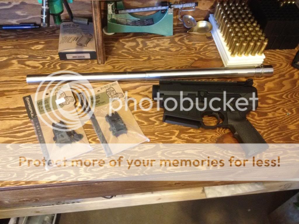

For a second it was hard to believe that this.....
Would become this!!
The Nightforce and rings are temporary. I'm waiting to get my hands on the new Vortex Viper PST 2.5-10x32 FFP but couldn't wait to see what type of groups it would do at some distance. If anyone knows of someone with the new PST in stock, please let me know.
Cheers

Beautiful rifle , Makes me throw up in my mouth when i think about these things being restricted. I cant wrap my head around a government telling us that we can only use something so beautiful where they say. Damn that thing is nice. All the great caliburs out there now. Drives me nuts.
Thanks all, I'm definately hooked on this type of rifle. I guess I've always been a fan of taking something and making it your own.
So what I've put together so far is this:
Mega Maten receiver set
DPMS 24" bull barrel (1:10")
DPMS BCG
Daniel Defense 7.62 lite rail
Magpul PRS stock
Colt A2 buffer tube with Spike's ST-T3 w/spacer and JPS polished spring
RRA lower parts kit
Magpul MIAD grip
I shot the first 20 rounds using the Magpul back up sights and have since pulled the NXS from my 700P to see what this thing will do.
I found out that my eyes aren't quite what they used to be.
I'm 99% sure I'll end up mounting the new Vortex PST 2.5-10x32
Another thing I'll be upgrading is the trigger. Waiting for the smoke to clear before I drop money on a Geissele High Speed
It's a super soft .308. I thought the carbine buffer setup might be a little harsh in a rifle length system but it feels softer shooting than my heavy bolt gun does. No FTE's so far.

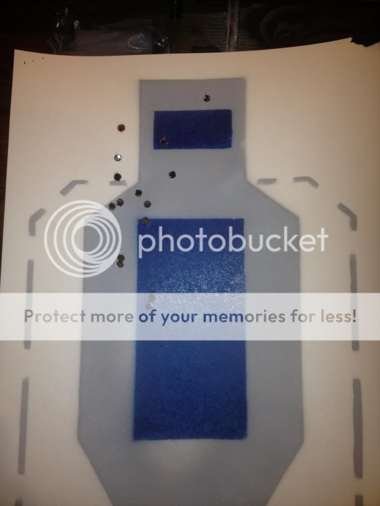

Here's a quick pic of the target I used to dial in the open sights at 50 yds

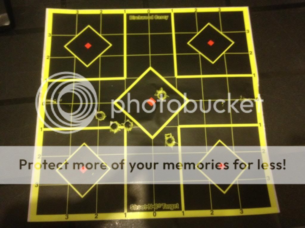

So I had a chance to get to the range this afternoon. I was in a hurry and forgot to bring my hand loads but had some factory match ammo with me.
I'm thinking this rifle doesn't like Nosler BT's. This is what I've been using for break in:
168gr Nosler Ballistic Tips
43.5gr Varget
CCI BR2
Nosler Custom Brass
2.810" OAL
100yds with the Nosler load:

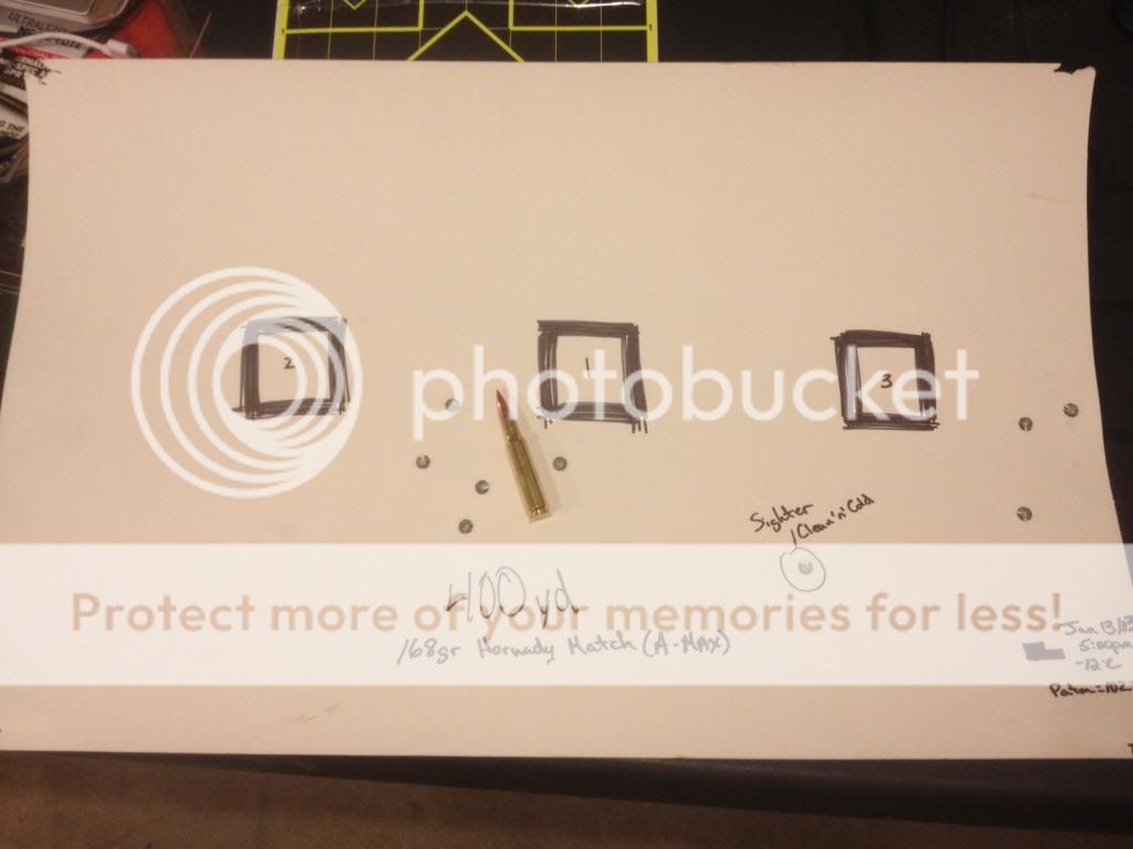

Decided to try the Hornady Match bullets at 400 yds:
Fired the sighter at target #1, 5rds at target #2, and had 3rds left for target #3
So far so good! 2.73" was the largest c-c spread. Hopefully this rifle will shoot the same or better after it's really broken in. Round count at this point is only 40

I've never shot 400y before. What's your measurements on the 100y groups ?
What's your measurement on the 100y?
And how big is that 50y target ?

To answer your questions, the 100yd groups with the Nosler's were holding around 2-3 moa. Didn't waste good Hornady Match @ 100yds.
And the target I used at 50yds is something I make myself for punching holes with my M&P40. The smaller a-zone (blue rectangle) is 1.5" x 3".
I wasn't going for groups on this target, just trying to get my back up sights close while doing my 3rd/cleaning process.

2-3 moa @ 100 ? Ouch. My stock Norc M14 will do 1.5 with plain 180g Hornady SP's and IMR 3031. And that's about the best it'll do, I've tried more accurate bullets and got no better results.
Yeah, it probably just does not like that load. The bullets are probably fine, just not the load. Varget is a good powder, but it is slightly overrated, don't rule out other powders and assume only Varget will give you the best results. The numbers I'm seeing here on Quickload look good tho', so it should work for you. If you even have a chance, try 38g of 3031 under some form of 170-180g bullet at 2.73 OAL. I'd be curious to see how that turns out.
So is that an 8.5x11 piece of paper the 50y is printed on ? I shoot irons at 100 all the time with my 223 AR. Got 26 of 30 prone on an 8.5x11 today, probably missed the few when I shot rapid. Got 24 of 25 standing but on a much larger archery bullzeye. Not sure where I'm going with this, it's fresh in my mind so I'm just talking.

Oh and that home made target of mine is 15"x20" (20"x30" poster paper cut in half). I bought the same sized sheet of foam core and cut myself a few jigs to allow me to just spray paint on whatever target style I feel like using for the day.
