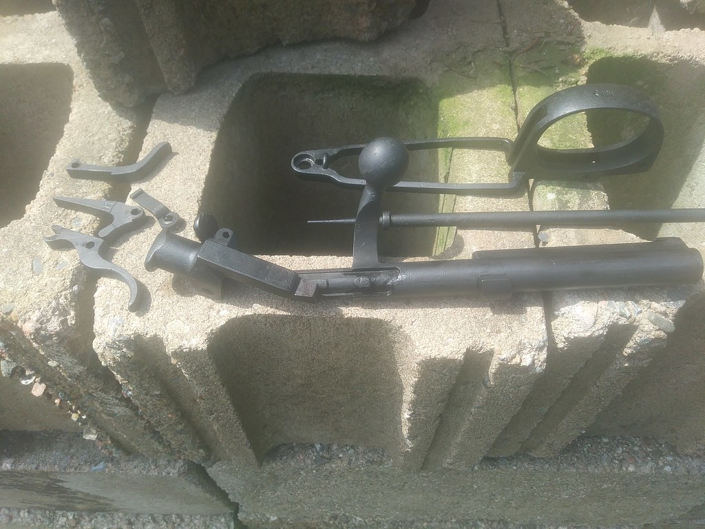

In the first picture, with the gun layed out and taken apart, under the barrel is the gas piston. That I kept clean and apparently from the bluing. At the right of the picture, set out on a white paper towel, the circular part in the middle and on the right is the regulator. The regulator is threaded and works as the screw to hold the action, spring and guide together with the cylinder. I blued the regulator, washer and cylinder (external) but kept the action, piston and all parts that showed no signs of being blued by factory apart from the process. Everything I blued, had already been by factory assembly. The orifice that receives the gas through the barrel is next to invisible it seems so small. Regardless of the holes size, the chemical reaction of blueing does not add or remove material from the metal it instead converts a small surface layer into patina, leaving clearances unaltered. At least to the bit of science that I tried to understand throughout my learning how to go about this.

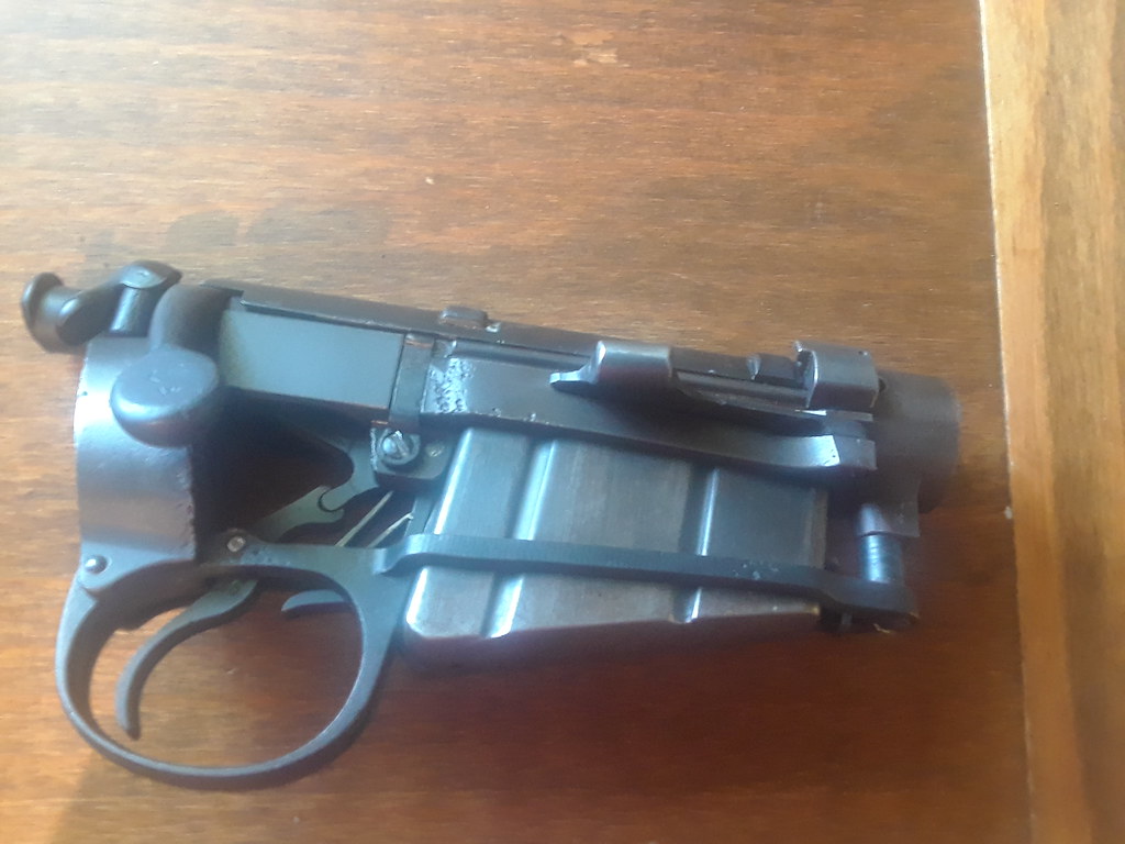

trying not to take away from your thread but add to it,
the top pics is a rust bluing job i did with the peroxide, salt and vinegar
the bottom pics are hot caustic bluing with stump remover
Very nice work, never heard of using stump remover chemical as caustic bluing. Great work!
