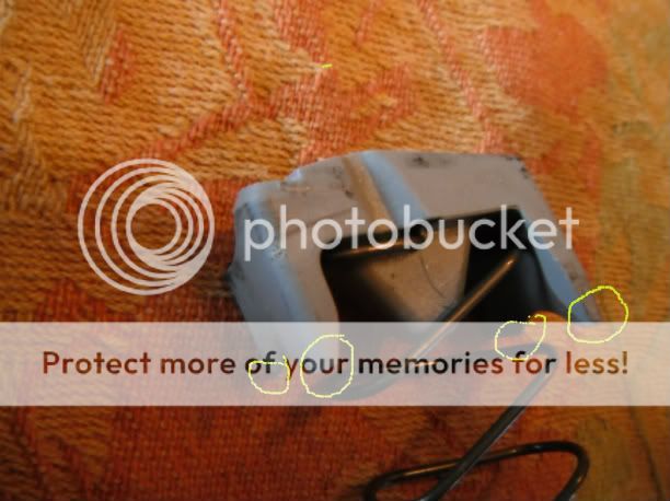

For mags that are tough to get the 10th round in. Is it possible to take the follower out and sand the bottom part that limits how far it goes down?
It worked for me. The tenth round now fits like the ninth; not as easy as the eighth, but much better than standing on the loader, thinking I'm going to break it.
I've got pics somewhere...here we go:
Take off an 1/16" at a time and check it. I took off about 3/16"
Disclaimer: Be careful. If you go too far (I really don't see how this is possible, please don't make an effort to prove me wrong), Brownell's sells followers for 2 bux.

So I did this 'fix' and now I CAN get 10, albeit tight, rounds in a mag.
However...
I CANNOT fit a mag with 10 rounds in the gun. Huh? Yup...10 rds won't go in, 9rd mags, no problem...
So...ideas?
No answers?
File a little more off, until that tenth round has a little give in it? Mine fit 10 1/4. I do have to slam the mag home though.
However...
So...ideas?
Use more force. My new .40cal mags are tight as a drum with 10 but still will load, with effort, when the slide is down.
