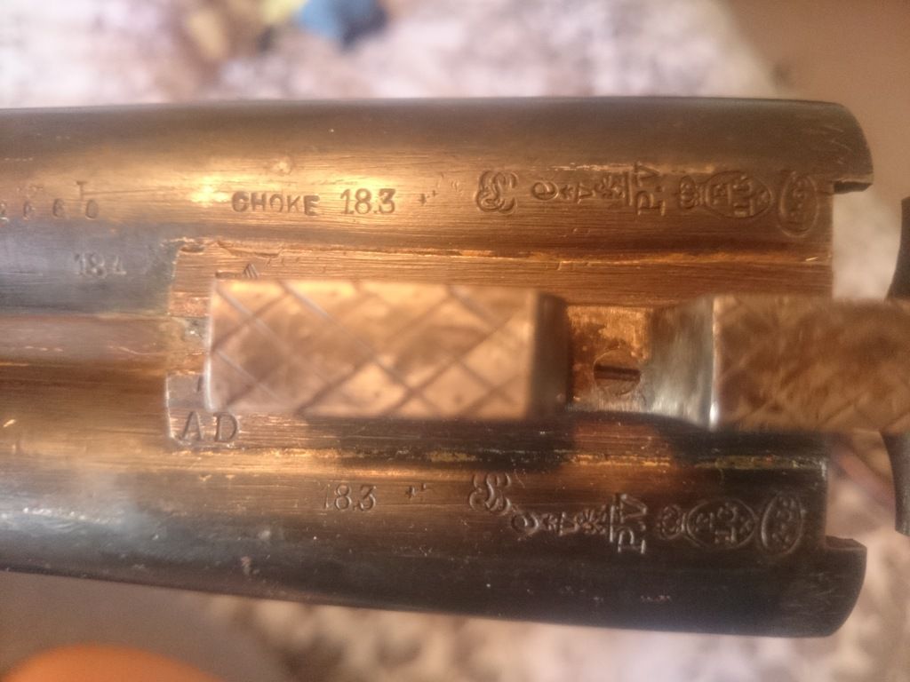

Would be for an old Belgian sxs that doesn't have a full 2 3/4" chamber. Yes it's been nitro proofed for smokeless powder.
Would it be safe to shoot 2 3/4" in it (I'm not sure) or will it even chamber & close on a 2 3/4" shell?

Ah Ha!!! That's the type of info I was looking for! Much appreciated. I have a gun in transit to me as we speak and the chambers are marked as 65mm ........ not 70mm typically associated with 2 3/4" but the seller says it busts clays no problem with modern target loads .............. I started to second guess the whole thing. Hopefully it's a nonissue and life is good. I think it's a good/better quality gun in what apperars to be excellent condition and not a low end early 1900's gun. I believe the date code is for 1926. Here's a shot of the barrel markings
