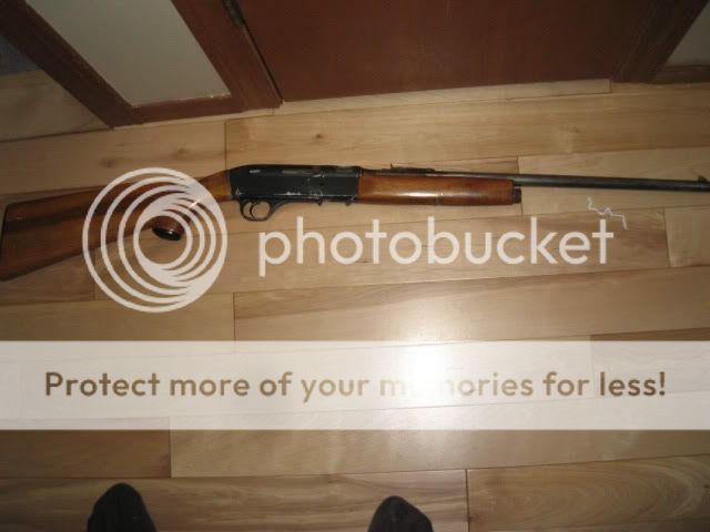

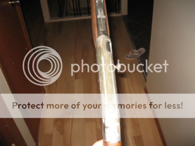

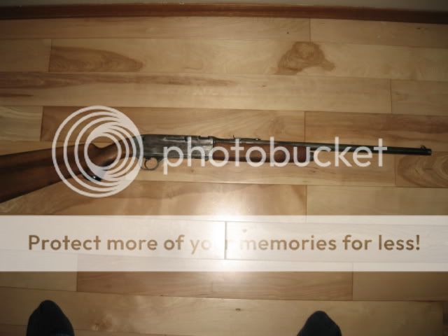

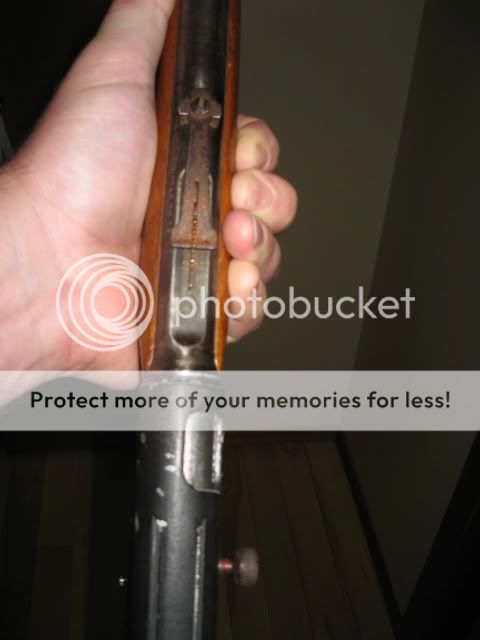

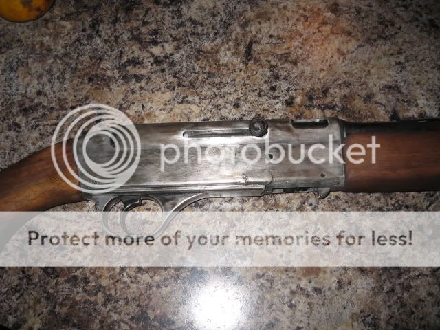

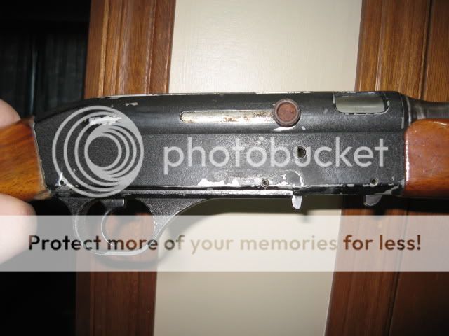

A buddy had this old Gevarm sitting in a safe.. he didn't have a magazine for it so I took it to see what I could find. When I told him what it would cost, he wasn't interested. So, I asked what he would take for it. He offered it to me for 20 bucks, it was pretty rough but I took it off his hands. I decided to make it a project. I blued it and gave it a Western Look. Now, I just need to find some magazines and see if it actually functions
Nice. I paid $50 for mine from a friend. Finally found a clip for it for $90. Apparently the clip oon the Gevarm is notorious for falling out and getting lost. I'd suggest silver soldering a small ring onto the bottom of the clip, running a line from the ring to the stock of the rifle. It's a sweet little shooter. No misfires with that built in firing face on the bolt. Open bolt firing takes some getting used to though. Congratulations on your new baby.
use black krinkle stove pain and heat the receiver before painting. This should give it a close to factory finish. If you didn't sand it down it would have worked better. A british armour told me about this for re-doing sterling 9mm smg's and it works great because it blends with the original finish. Since gevarms are finished the same way it should work. But, you have to get the heat right to make the paint krinkel..
