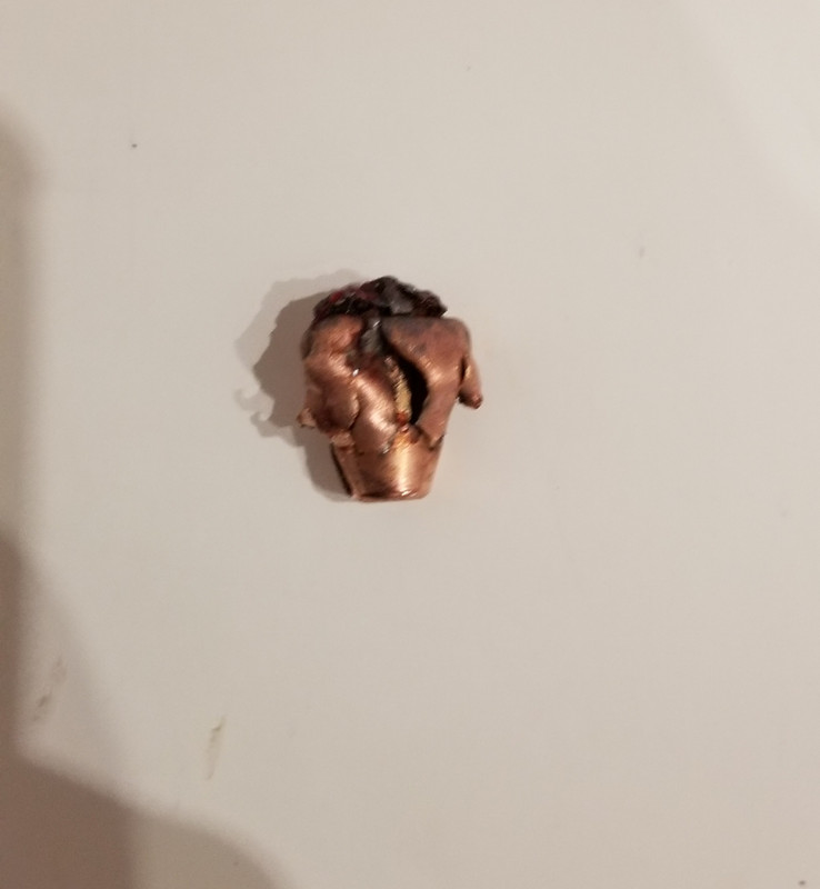

140gr federal trophy bonded tip recovered from a bull moose on side ribs. The bullet shattered the big knuckle joint at the bottom of the scapula so I can't really fault it for not penetrating too far. I found it resting against a rib. Retained 112 grains.

I thought I would add pictures of spent bullets collected over the years
168 TTSX out of 300 WM. Moose shot at 175 yards, muzzle velocity 3000 fps and impact velocity is approximately 2650 fps
168 TTSX out of same 300WM. Elk shot at 70 yards, velocity approximately 2850 fps. There were originally 3 pieces found on the entry
165 TTSX out of 300 WSM. Elk shot at 40 yards and impact velocity approximately 2900 fps
168 TTSX out of 30-06. Taken from this years elk at 75 yards, impact velocity 2650 fps

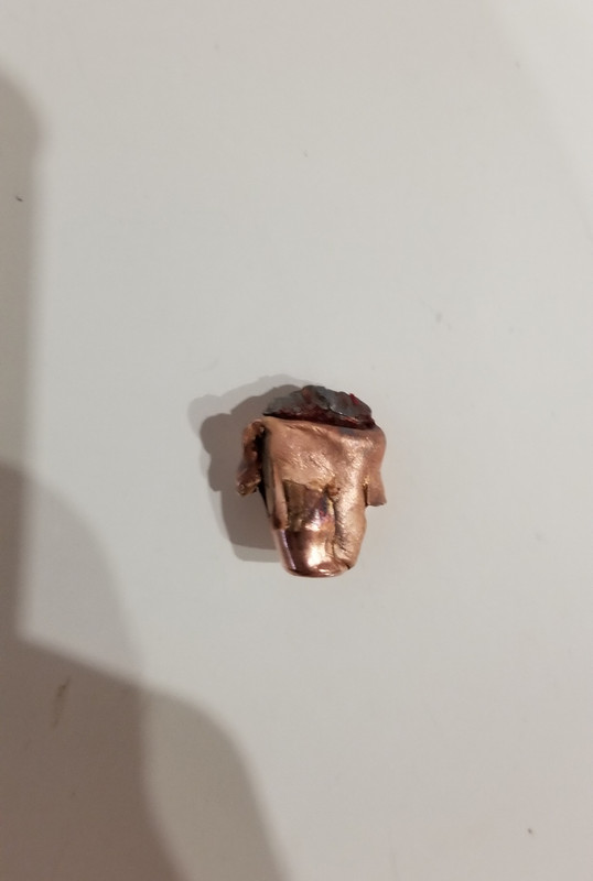

Well I had a bit of a suprise tonight at supper. I did up a bug batch of moose ribs. I ate my fill and as the wife was cleaning up and knocking the meat of the bone I hear "wtf is this?" Well here my 2nd shot on my fall moose ended up being lodged inside one of the rib bones. It was my finishing shot and the bull was facing me at about 20 yards. The 140gr trophy bonded tip hit a rib dead center on the skinny side. It performed very well and held together nicely. Didn't weigh it yet but probably around 110-125 grains
