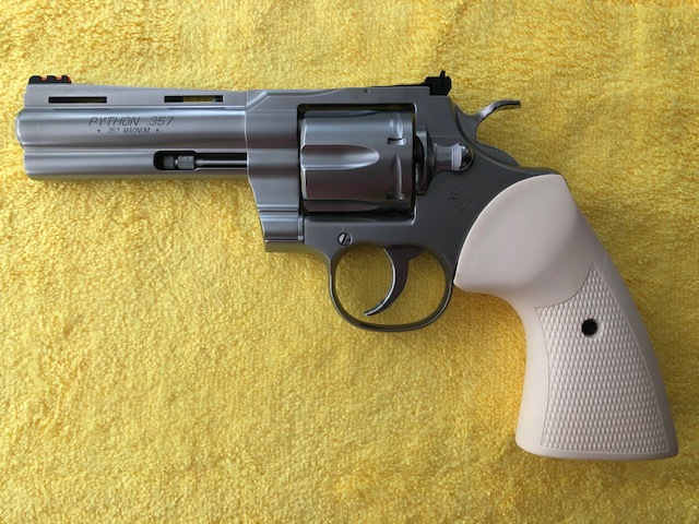

My 2020 Python is now glass bead blasted for a superb satin finish.

Good info, thanks.
Please post a photo of the revolver when you get it back
Wow - looks great !

Yes I did it myself....very easy; I bought a King sandblast cabinet with glass beads and I'm very happy with the result.

The “dark” look created by the finish makes that look awesome, I also think the white grips somehow accent that. Great work and very nice results! You actually made me think about one of these new Pythons....
I actually don't mind those 'ivory' grips on there. The bead blasting gives it a very nice look. If I was going to suggest a grip for it I would go with some G10 from VZ Grips...like these. I have to admit though, I took those off, as shooting hot .41 magnum loads was no fun with those on, so it now has Grippers from Pachmayer. But! They would look ###y on the Python, and be plenty comfortable.
