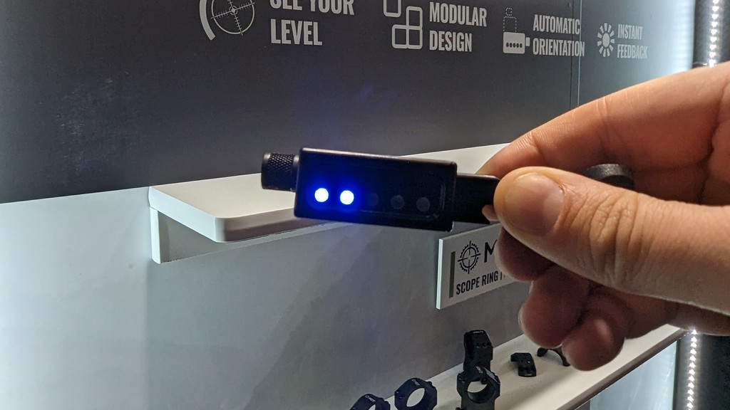

Next is the electronic level for placing on your precision rifle. Mountable on your rail, it can be placed right, left, or vertical and it will self adjust. Really interesting.
