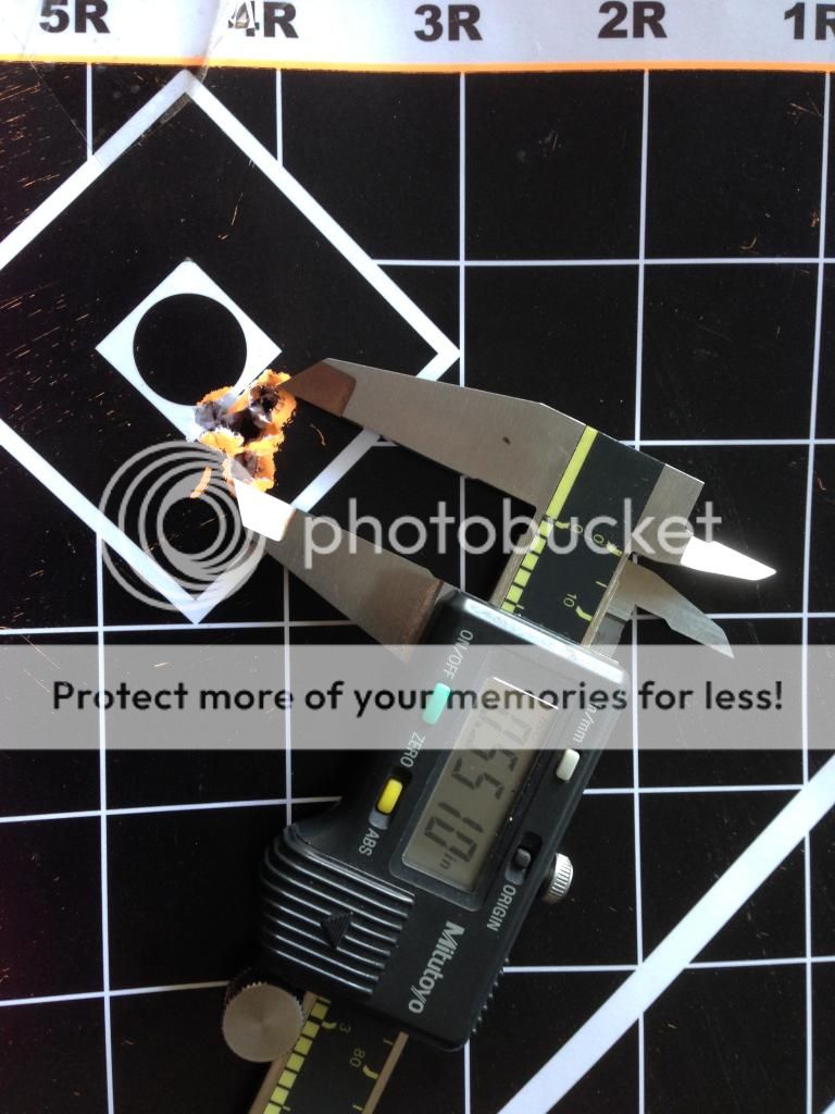

Just a quick update, I have settled on Varget, at max book load 28gr. I spent a lot of time on COL, and 2.320" is the most accurate and still feeds. I came out a lot farther (2.360), still not touching the lands, but groups opened up. Running right at 3700 on the chrono, so I can order my CDS dial now for the 39gr blitzkings (also good speed with 22" LVSF barrel). I consider this pretty good for a factory barrel/chamber (5 shots/100yd). The leupold firedot reticle is .6 moa, the target shown below seems very good for shooting groups, as I can really center in the diamond.
