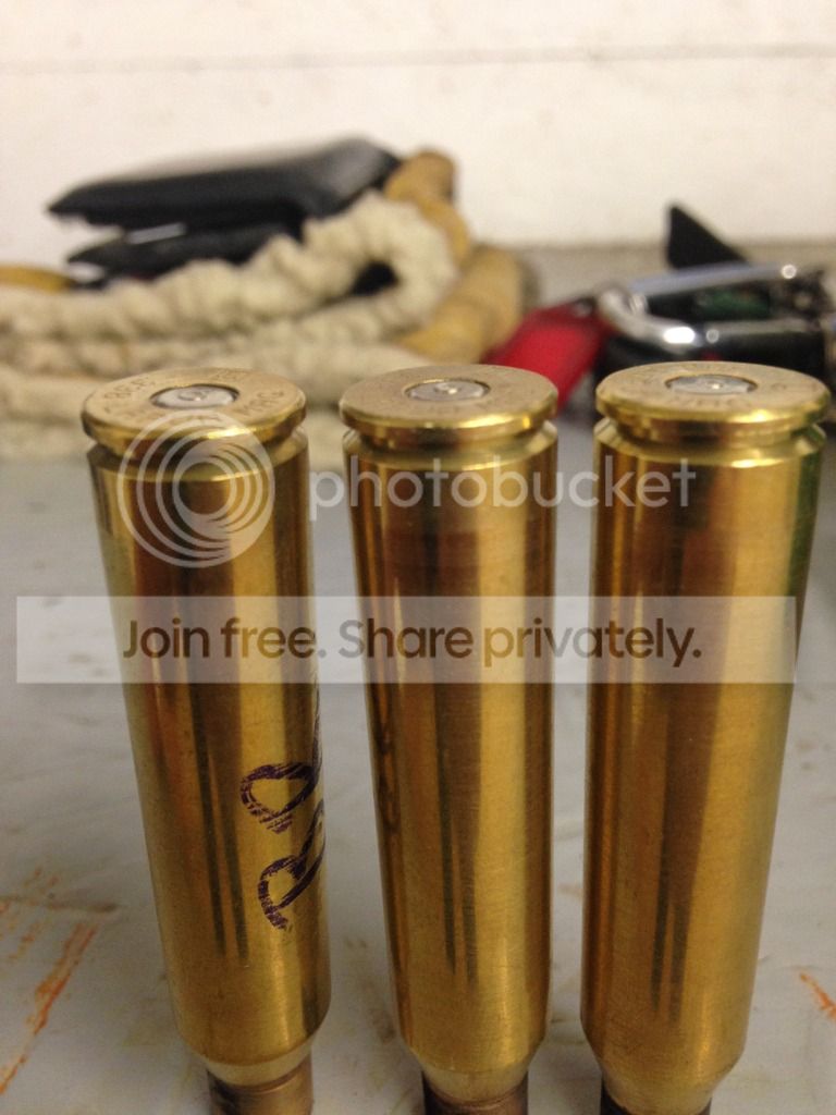

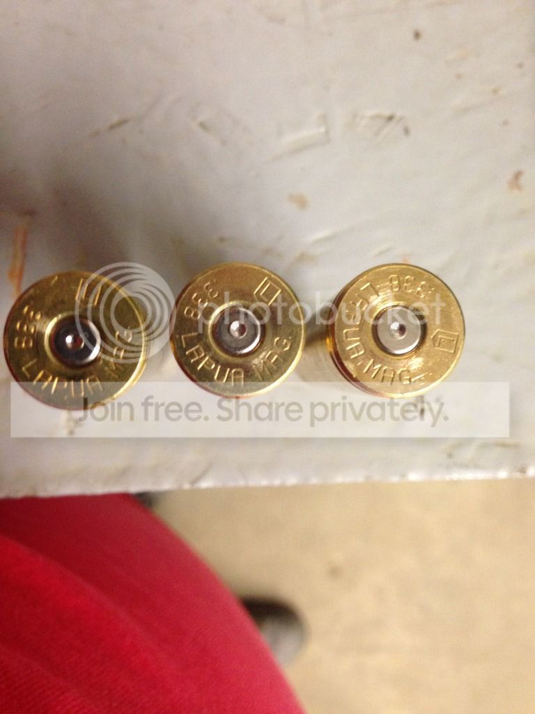

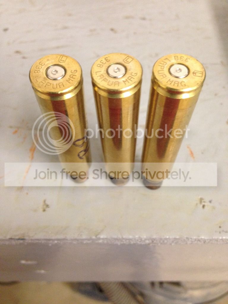

This morning I went out to see if there was a physical difference at the back end and then a difference on target.
Left is the BR , center 215 , right 200.
Group sizes I cannot say were really effected, the BR might of been slightly smaller than the other two.
However the CCI(both BR and 200) did have about 1 MOA drop at 500 yards compared to the Federal, it calculated out to a loss of about 50 ft/sec at the muzzle.
