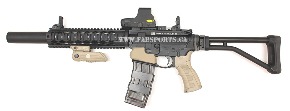

I'm looking to buy the ST Dedicated upper, or a ST-22 if possible. Anyone know of any Canadian companies that have these? Questar doesn't, and it charges an arm and a leg to import one.
See post #15 where Fabrice says that he is waiting on a shipment in response to Jono's question about ST uppers...
That said, if Fabsports is getting them in I suspect Questar would be too (purely speculation though- only Mark could answer that). He has carried Spikes products before and if they are issuing export certs for them again, I can't see why he wouldn't bring some in (given demand of course). Either company has a stellar reputation so I think it doesn't matter who you buy from.
