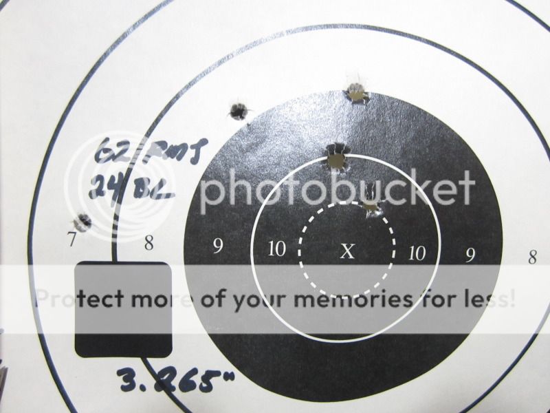

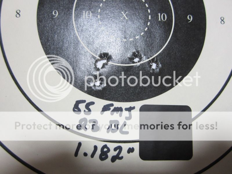

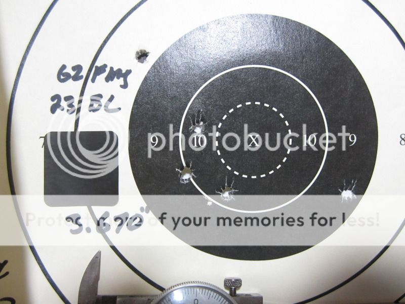

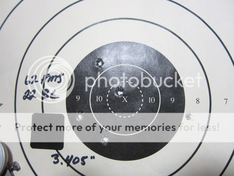

I used the opportunity to test some ammo in the 223 CZ at 50 yards. I did this once before and the results were surprisingly good. Three things are clear to me:
1. Just like the Norc M4, the milder ammo worked better than the hotter stuff.
2. The 55 gr bullets do better than the 62 (just like the Norc).
3. This little carbine has excellent accuracy.
The 22 gr of a powder similar to BLC2 is only about 2300fps, but it was enough to cycle the action 100%. I think this will be my new CQB load. I shoot CQB with my Norc M4, but the CZ has been my back up rifle (I like the irons if it is raining) and it is the rifle I lend to newbies because it is 100% reliable and simple to operate.
