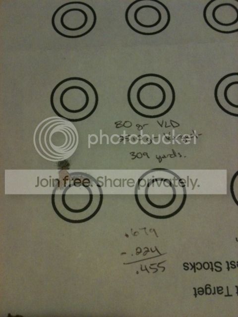

I'm also working around 23.6-24.0 gr of varget with 80gr vld's, not sure on velocity I need to get another chrono.
I'm using 80 gr SMKs, Lapua brass, 205Ms and 24 grains of Varget. 2860 fps out a tight chambered 1-8 , 28" Gaillard barrel. It's plenty warm, single digit ES. 23 looks good at 100 but spreads are close to 100fps.
80 grain VLDs were also good at the same load, if anything maybe a bit better. Sometimes you have to shoot up what you have.
