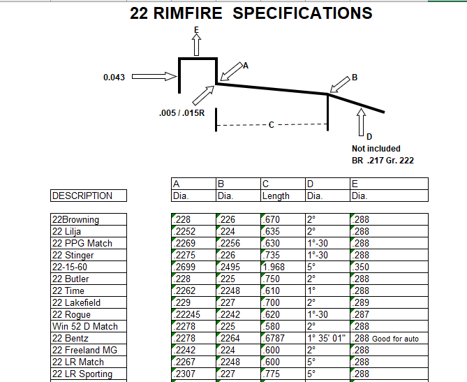

With all the interest in CRPS/PRS/NRL style rimfire, I am curious as to which reamers are being used to chamber barrels.
Please note, this applies specifically to magazine fed, bolt action rifles that are shot in all conditions in "practical" competition. I respect and admire the skill of the shooters and the accuracy of the equipment in many of the other rimfire disciplines, but a chamber that works well in a single shot BR rig may not necessarily be the best for field competition.
Also, for many PRS shooters, the 22LR is a trainer version of their match gun, so it may seem oddly large and impractical for a rimfire, with 24 inch+ heavy barrels and the like.
I've done a bit of lurking on rimfirecentral.com and snipseshide.com as well. Seems like the Calfee 4 and Lilja 2 chambers come up a lot.
If someone has actual experience, that would be a plus.
