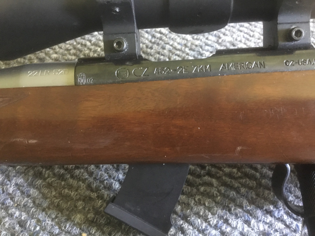

Contact KS Arms in Edmonton. They are now making barrels for RimFire ... to your specs. I had them put a sporter contour on a CZ 452 American that gave me 50 yd agg. in the .3’s with CenterX. Karl gave me a box of SK Long Range Match which shot as well as the CenterX but I have not made time to do serous testing for aggs at 100M.

KS Arms chambered their barrel with a 52D reamer. No doubt I will get them to make me a heavier contour RF barrel come spring. Plan to put it on a CZ 452 Varmint.
