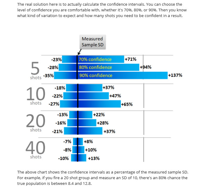

Readers should be aware that statistically the level of confidence we can have in numbers such as SD and ES depends on the sample size of the data. In other words the larger the sample size, the greater the confidence level in the data.
A sample size of 5 shots is very small. While it's impractical to chronograph a sufficiently large enough sample size of ammo to predict its ES and SD with near 100% certainty, it is possible to increase the chances of finding data in which we can have a relatively high level of confidence.
I've been looking for a to-the-point explanation of this, but haven't been as successful as desired. Nevertheless, here's an explanation of confidence levels with regard to sample size and SD calculation by Adam MacDonald, a Canadian shooter who writes a very informative blog. It shows how a higher number of shots increases the level of confidence we can have in the data. It may take a bit to figure out what the information shows (I had to think about it for some time) but it does illustrate the point very well.
According to MacDonald,
From "Thinking Statistically" h t t p s://www.autotrickler.com/blog/thinking-statistically
Paraphrasing MacDonald, he reminds shooters that ES five shot samples can rule out a bad lot of ammo; standard deviation can prove a good lot of ammo.
Numbers are just numbers . It can be difficult to draw any concrete conclusions based on one time out ( like today ) . For example , one 5 shot group with "worse" numbers actually produced a smaller group . Was it me ? Was it luck ? Was it coincidence ? Who knows . What did surprise me was the effect on the printed group 25fps had at 50 yards . When a round hit low , it was always accompanied by a lower MV . It was 100% repeatable regardless of the ammo . Today also brought into focus the importance of quality ammo . This particular CZ457 MTR does NOT like CCI SV . Regardless of what the numbers show , it shot like crap every time . But , the same ammo shoots much better in my Anschutz MPR . This CZ 457 MTR with the shorter 20.5" seemed to be much more sensitive to differences in ammo compared to the 25.6" Anschutz MPR . It produced higher MV's which really showed in the POI . Faster ammo printed higher . Not really as apparent with the MPR . MV's were lower , but , it's POI was more consistent . Rimfire is a funny beast . There is no substitute for testing to see what works and what doesn't .
