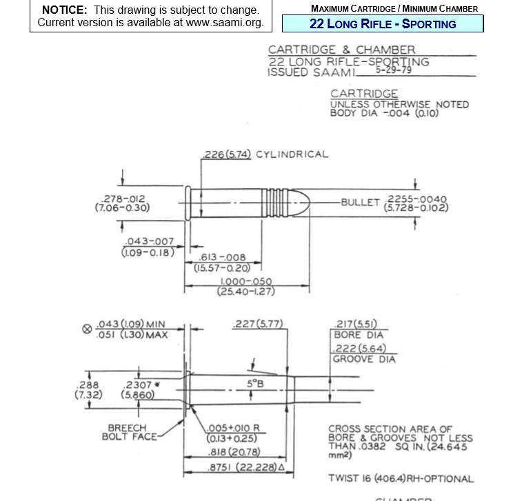

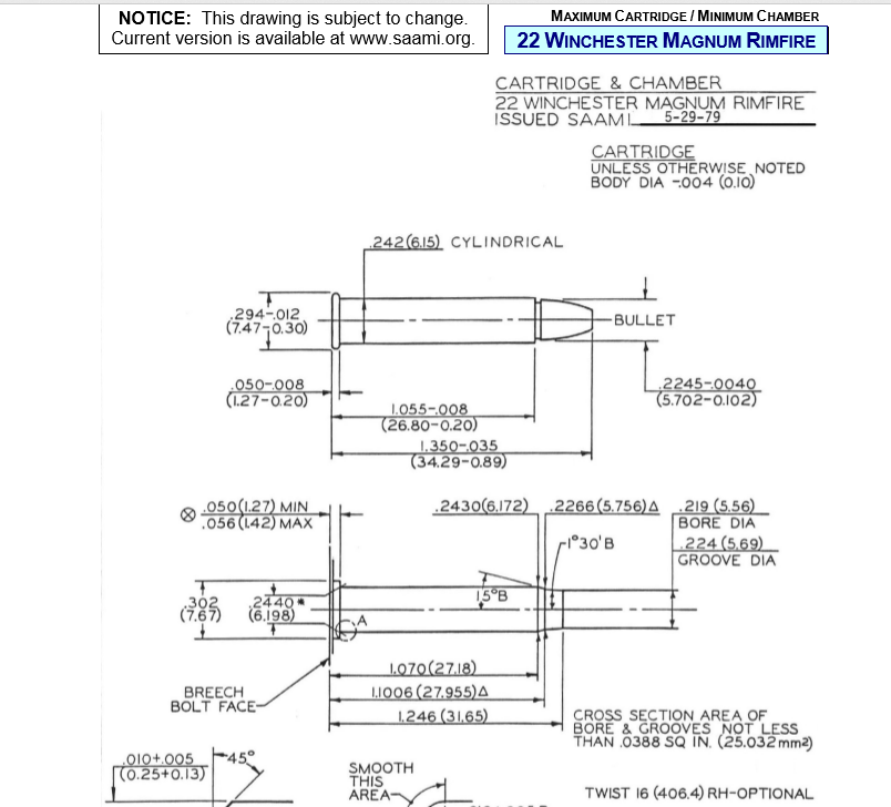

I was discussing these two calibers with an engineer working for a rifle maker, and he shared this as part of our discussion:
The mag bore and groove was .002 larger the 22 S-L-LR as per SAMMI spects.
I chambered a batch of 22 Mag barrels with 22 LR chambers and targeted them and found they shot
better than the LR bore. Since 22LR rimfire barrels were chambered as the first assy operation and then
roll marked I wanted to standardize all rimfire barrels and start assy. with chamber and roll mark.
