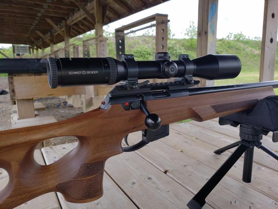

Without any difficulty I quickly dismounted the Schmidt+Bender KK50 scope from my .17HMR 1727F by simply giving the Talley Signature levers a quick twist.

I installed the scope on my .22 1761 and headed to the Stittsville Shooting Range outside Ottawa on a beautiful afternoon to test a couple of .22 brands.
I had installed the Anschutz Picatinny rail in order to mount the S+B.
(Careful...the hex heads are metric and somewhat soft)
