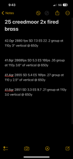

I am currently doing load development for the above shown rifle. I am using Alpha Brass headstamped 25 Creed so I havent had to do any neck sizing of Lapua 6mm or 6.5mm Creed brass. Using IMR 4350 at this point because I have lots of that powder. I know H4350 has had excellent results and the burn rates are quite similar so I hope to find a happy load. I am using CCi 450 primers as the brass is small rifle. Bullet choice is the Berger 135 Hybrid. Initial results are encouraging, some 1/2 MOA groups. Sadly the chronograph was a bit wonky so the velocity data is suspect.

IMR 4350 should work just fine in the 25CM, I use it in my 6mm CM behind 112gr match burners and get 3000 fps with no pressure at all, could probably get another 50 or 60 fps but that load is so accurate I don't want to mess with., the BC is .624 and at 3000 it is flat shooting. The 25CM with 135gr .635 BC bullets at 2900 should be a dandy

Its a Curtis Valor Action with a MDT CRBN stock and Trigger tech diamond. The Barrel is a Carbon 26" 1/7 twist M24 contour from Patriot Valley Arms. Project was built by EM PRECISION.
