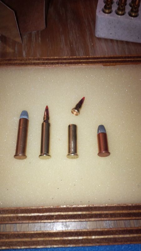

The 17 Winchester Super Magnum ($20/50 or $0.40 each) are based on the 27 cal nail gun blank with a length to the shoulder about half way between the 25 Stevens short and 25 Stevens long, the case is 10 thou smaller in diameter but the rim is the same diameter and since it seals and headspaces on the rim I should be good.
I picked up a box to see if they would even chamber and after cutting the case at the shoulder then do, the extractor fits great over the rim and although it took 2 strikes the firing pin did fire off the primer with no powder.
Here is a picture of the cases, from left to right, 25 Stevens Long, 17 Winchester Super Magnum, case cut at the shoulder, 25 Stevens Short.

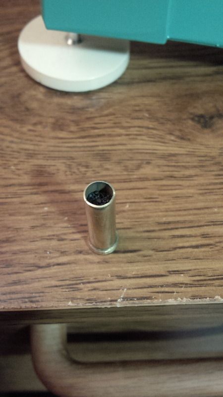

I took the 0.5cc dipper and leveled it off with FFFg and tossed that on my RCBS scale, the load came out to 7.5gr.
Here is a photo of the load in the case.
