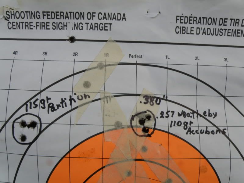

257
The load on the left and right are 71.5gr of retumbo with WW brass and mag primer, 115gr partitions were .480'' and the 110gr accubonds were .380''

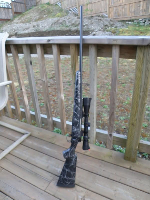

The rifle is M700 with a gaillard barrel and Mcmillan stock.
Cheers John
