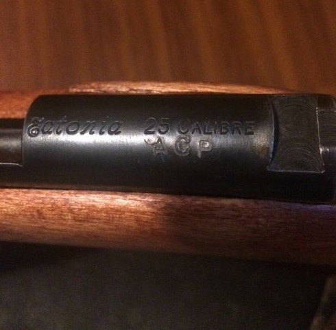

So a few weeks ago I decided to take on this winter project for no better reason than to see if it could be done with layman's tools on a budget. So I picked up a .25RF, Eaton's "Eatonia" (Cooey Canuck I believe) barreled receiver, a bag of .25 ACP brass, and some .25 cal "Grizzley" HP airgun pellets that are sorta like shallow Minie Balls with hollow points.

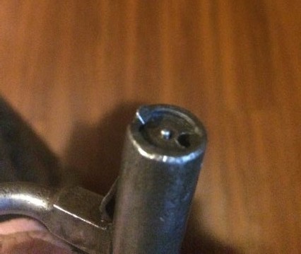

I removed the firing pin and it's retaining pin and drilled a new hole in the center. I was gonna weld over the old firing pin hole but I just didn't see the need to. I then had to make a new firing pin and figured the best thing to do was to get another striker from another cooey bolt (I had an old broken one) and make it out of that. The striker is basically shaped like a nail without a point and the head of the "nail" is what hits the firing pin. The head is the same size as the inner diameter of the bolt so all you have to do is trim it to length and spin the shank in a drill press while filing and sanding it to shape out a pin the diameter of the new hole drilled in the bolt face.
You end up with a firing pin shaped like a steel thumb-tac. I cut a small hole in the rim of it for a retaining pin as this firing pin, like the original RF one, is free floating. I wish I had taken a pic of the firing pin but I forgot to and I really don't feel like taking this bolt apart again.
I had to drill a new hole in the bolt body for a new retaining pin. I used a roll pin.

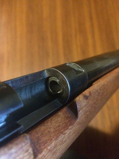

Now as for the barrel, I had read on other forums that it would have to be sleeved, or have the chamber end cut down, reamed and reinstalled. I really don't see why any of this was necessary. I don't have any .25RF on hand but from what I have researched, the case diameter is the same as .25ACP. It's longer, but so is .22LR vs .22 short and there's no problem there (my barrel is also spot on 18 inches long so cutting it down even a mm is not an option, legally). The only big issue is the rim and extractor grove. Now the .25ACP does have a rim, so it will headspace, but it's not very big and it's meant to be extracted from the grove. So I had to figure out extraction.
It was really as simple as just trimming the section of chamber that's swept by the extractor as the bolt rotates closed. I did this with a dremmel and grinding bit without even removing the barrel from the receiver. I didn't even have to tinker with the actual extractor at all. It extracts just fine after giving it clearance to snap into the cartridge extractor groove.
