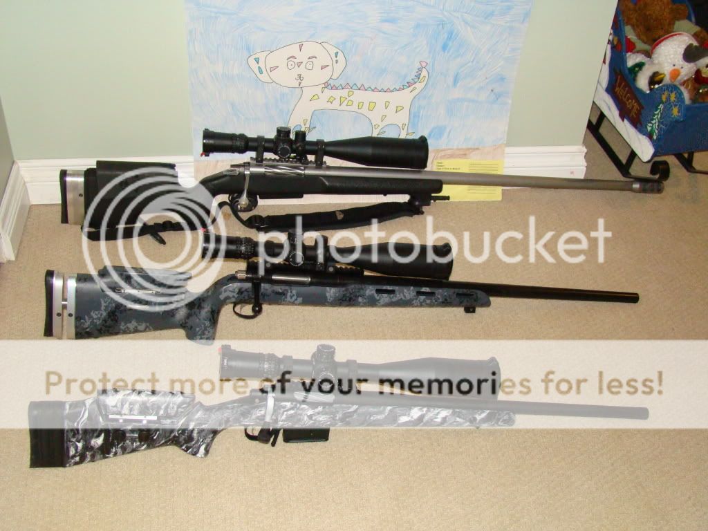

Nice looking rig, what barrel contour did you use? The rifle doesn't look too heavy and she shoots just fine.

Thanx guys. I've been shooting a 260Rem since before commercial brass was available. Pretty happy with it, so it's still up to the jerk on the trigger.
