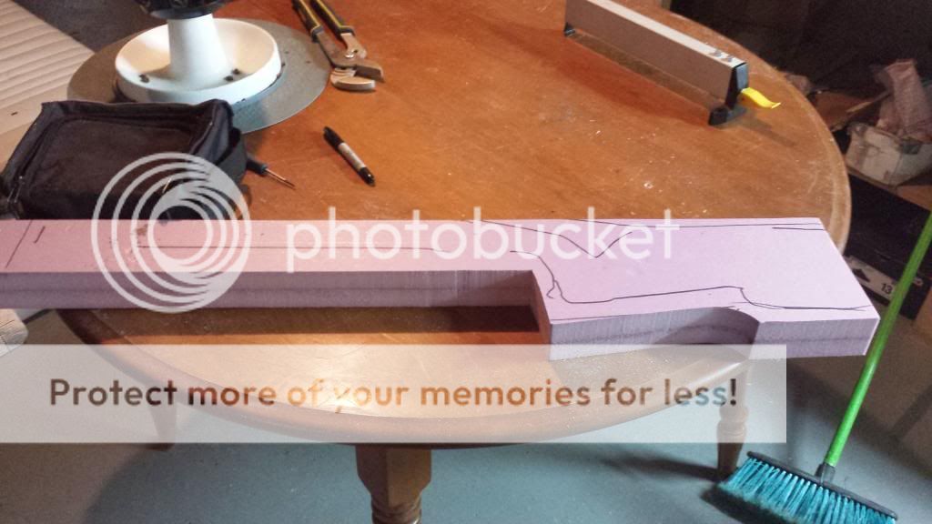

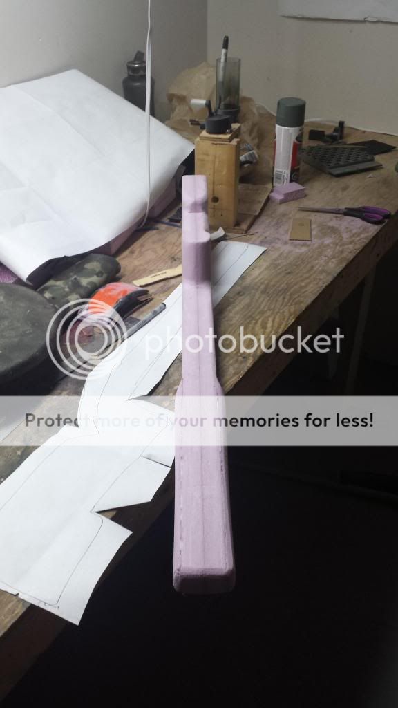

Well I managed to sneak away for a few minutes here and there today and started working on the foam core for my next stock. Here are a couple pictures.

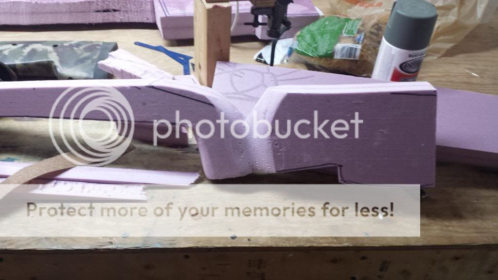

The first picture is after rough cutting my "blank" on my little band saw. It is 2 pieces of 1" foam that I glued together with white glue and let sit for a few days.

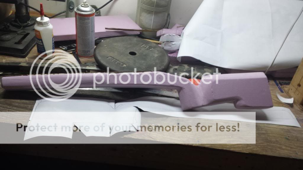

This picture is after some more trimming and some initial shaping. I'm doing all the shaping by hand with 80 grit sand paper on a sanding block and by hand. The 80 grit makes really quick work of the foam. You can take more than originally planned off in very short order.

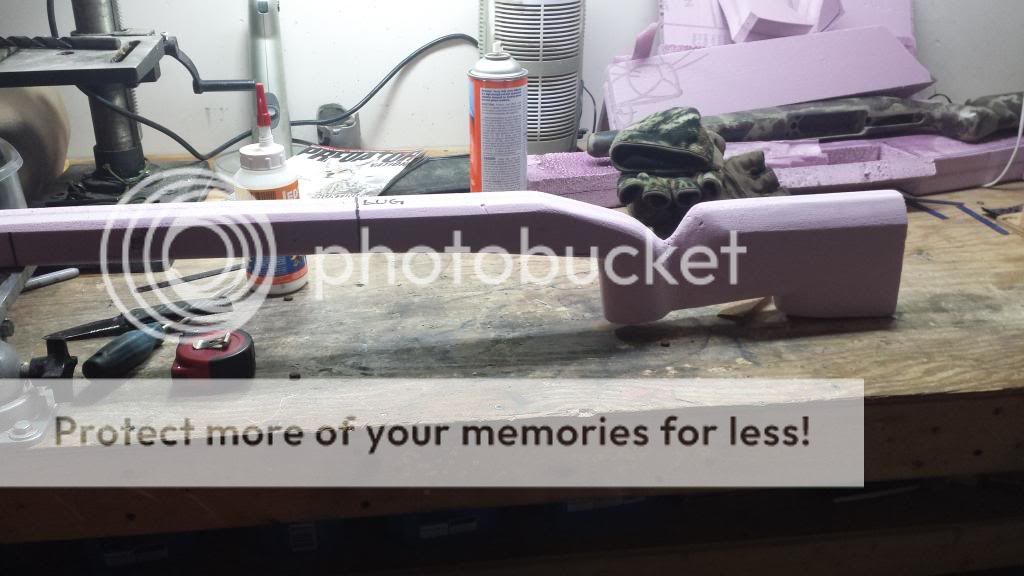

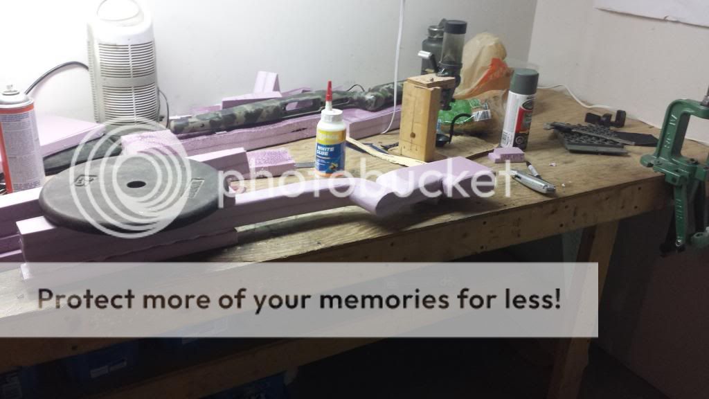

Here is a picture after I've done a lot of the shaping around the pistol grip and the butt area. So far I have about 1.5 hrs into cutting and sanding.
Here is how it will sit for the night, I'm adding some more foam to the fore end to widen it up a bit. Unfortunately I'll be sanding about 90% of that foam back off.
I ended up trimming the stock too short (height) I will have to add about 1/4" or so back to the bottom or top at some point.

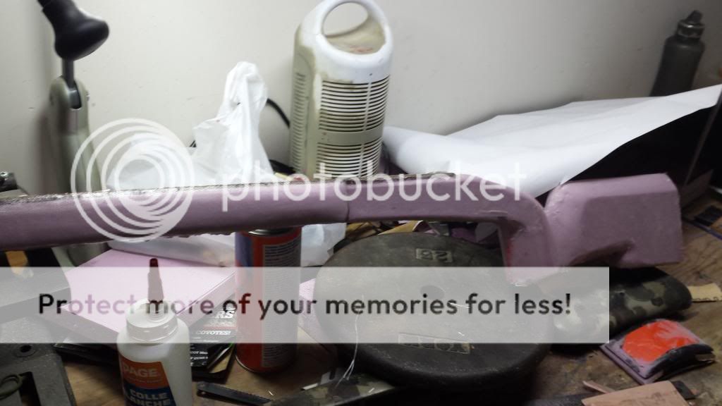

Here it is after sanding the foam slightly undersized.
and another

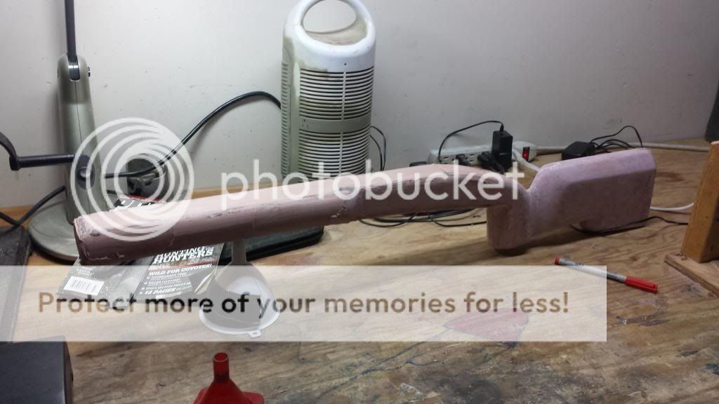

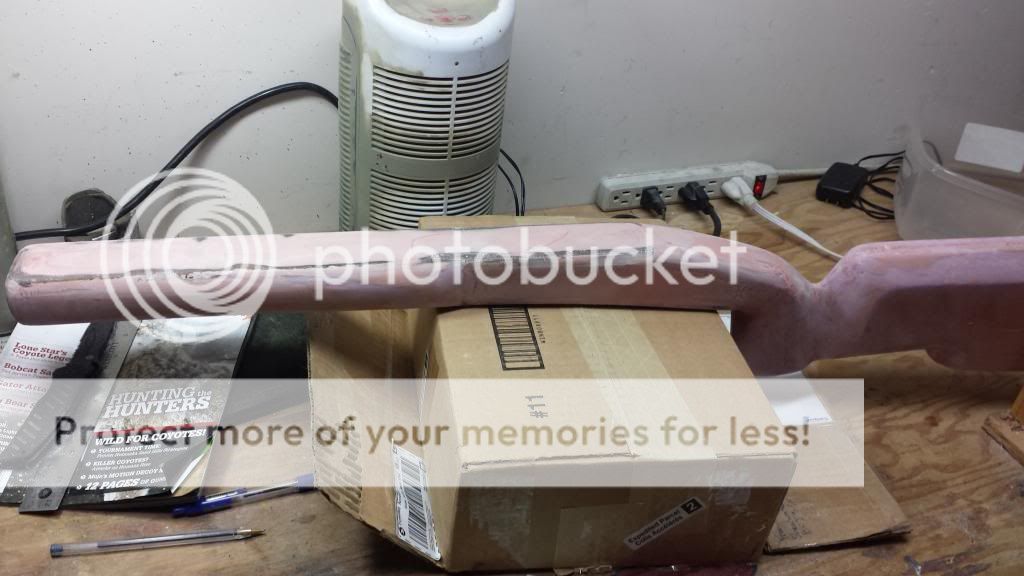

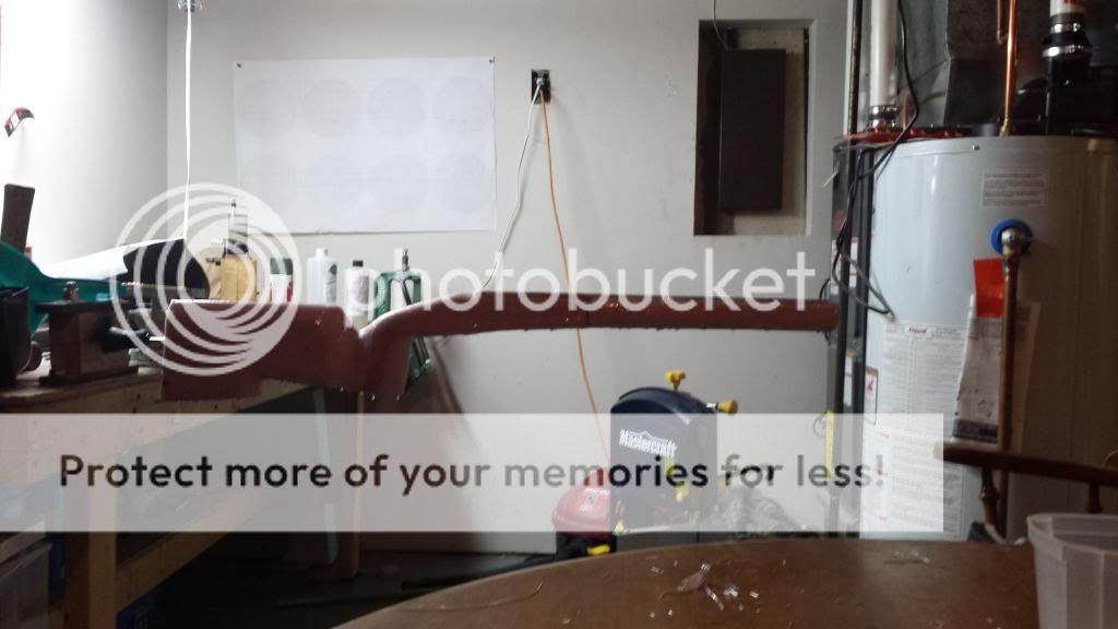

Here it is after I put a single layer of fiberglass and epoxy on it. Its hardened but I haven't sanded it yet. You can see where I used a layer of cardboard on top to gain back some height to the stock after I mis measured and mis cut the foam.
Here is how it sits in my basement now. I stabbed a screw driver into the foam to hold it up so it was easier to work on. I put a second layer of glass on in a few places. From here I will sand the high spots down and put a layer of filler on it and sand/fight with it until I'm happy with the dimensions and finish.

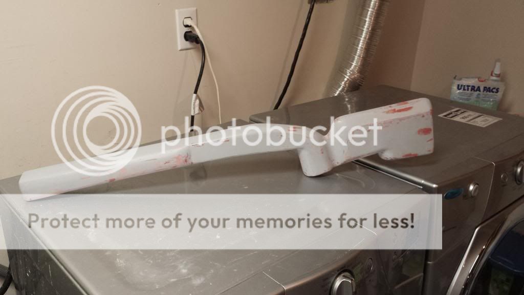

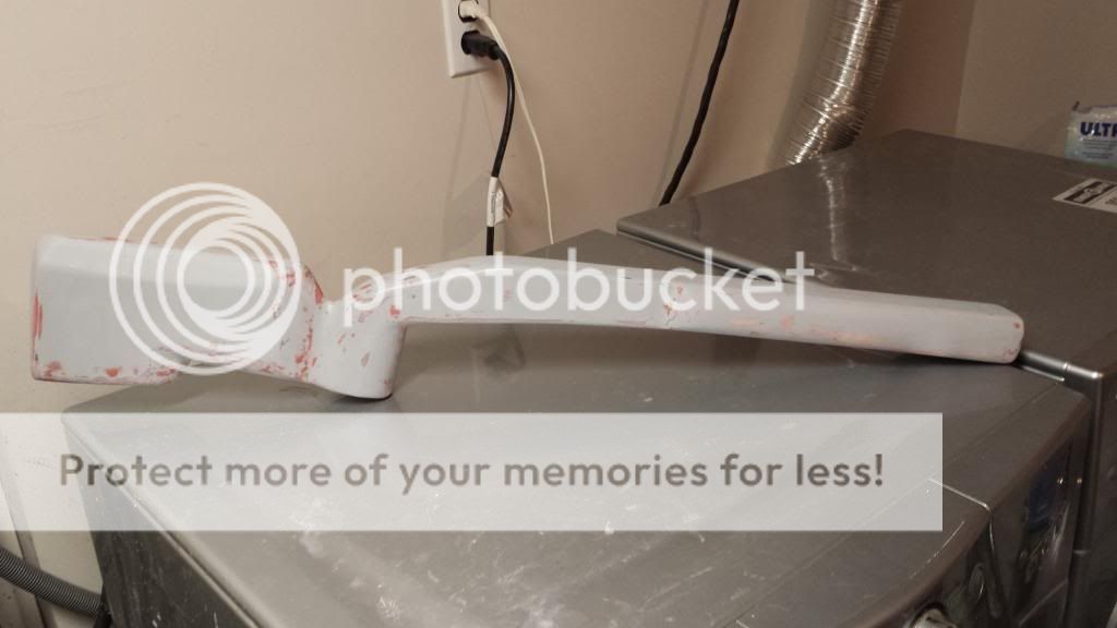

Been a while since I posted any progress. It was slow over the Christmas break. Here are a couple pictures of where I am at as of now. First coats of primer and some spot putty in places that needed attention after being painted. I did discover a very time consuming error when I was making the foam portion of the plug. As I mentioned earlier I mis measured and mis cut the foam so I was about 1/4" or so too short, So I decided an easy way to get that back was to use a piece of cardboard on top of the foam and under the fiberglass. This was my second mistake, which led to the discovery of my first mistake. I have been wet sanding everything in my laundry tub essentially. I hate dust, and the paper lasts longer before clogging and such. I sanded through the fiberglass and into the cardboard in a couple places, which led to soaked cardboard under the glass. This made the top of the plug soft and hard to work with. I tried to deal with it and hoped it would dry out while I went to NB for a week to see some family. It didn't, so when I came home I fired up the dremel and cut the top off the plug and got rid of most of the cardboard sheet I used. I then put 6 or so layers of fiberglass and epoxy on to reinforce and build some height back up. I then proceeded to use a lot of body filler and 3 days to get back to where I was before. This led to the discovery of my first mistake and that was to use plain white Elmer's glue. Well it doesn't like being wet either. So if I go to make another plug in the future I will ensure I use waterproof glue and there will be no cardboard or similar materials in the plug.
Any ways here it is now, hopefully get some more paint on it tonight.
