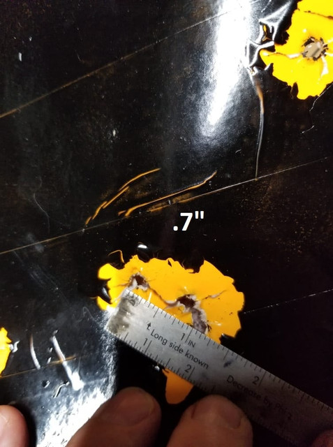

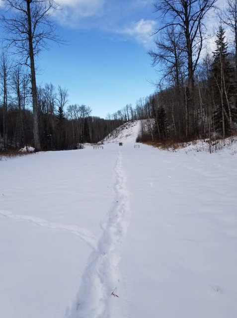

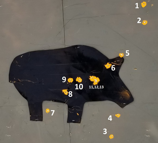

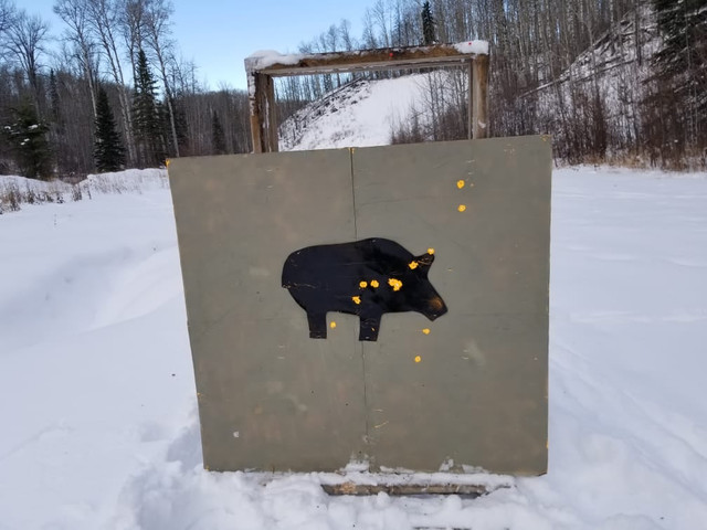

I got out to shoot a bit in the "warm" two degree weather today. My range isn't really set up for prone shooting. This was my first time shooting from cross sticks at a silhouette target. I set up a full sized pig target at 300M. It took a bit of sight adjusting from my 100 yd zero to get it dialed in, but I amazingly put the last 3 shots on the pig into 3/4" with iron sights!! ��
My .308 with 16 power scope and match ammo can't even do that!

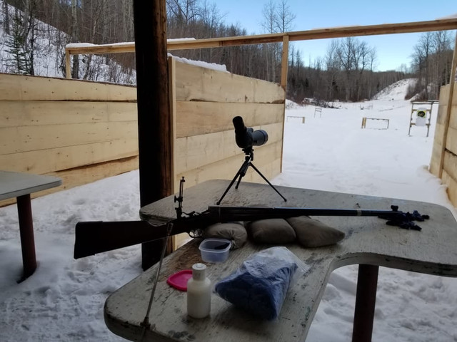

This is with my Pedersoli 45-70 rolling block loaded with CCI 200 primers, 67.5 gr Swiss 1.5 fg, .02 card, .06 fiber wad and 522 gr Lyman 457125 bullet lubed with SPG
I'm not sure yet. It was my first time shooting from the sticks, and first time not shooting at a circular target. I plan on trying some more at a 385 meter turkey target next week. We'll see how that goes.

Yes I use a vernier and globe sights. Rear sight is the Pedersoli mid range soule sight. Front sight is a Lyman 17 sight with a small circular aperture insert. Lee Shaver makes the inserts.
The target I made myself. It's orange posterboard covered in a layer of packing tape. Then you spray paint it. When the bullet hits, the paint flakes off around the hole, and it's easy to see hits in a scope. What rifle do you have?
I should also mention that I swab between shots with 2 patches dampened with 10-1 mix of water/Ballistol and the bullets are cast of a 20-1 alloy.
