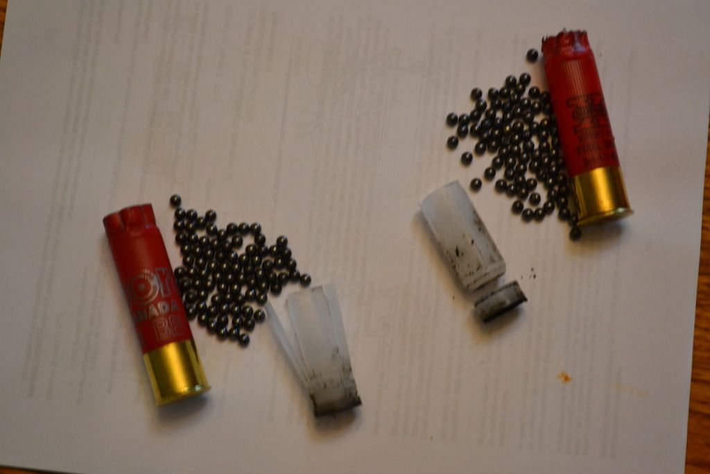

OK. So I'm a thrifty bugger and when I go goose hunting I rarely go more than 10 miles. Because I don't invest a lot into these hunts I generally buy the cheapest shotgun shells I can. I have used a lot of Winchester Super X in the past, but have been disappointed with them at times. This spring I saw Score 3" 1 1/8 oz steel on sale at WSS for $12. I bought 3 flats. I did a quick test tonight to compare them to my remaining stock of Winchester Super X. Both shells are 3" 1 1/8 oz BB. I pulled one of each apart to examine and weigh the BB's and the wad. Then I shot two of each over a chronograph and patterened one of each. Rounds where shot out of my Beretta A400 with a Mod choke. I know this a very basic test, but it's all I had time for.

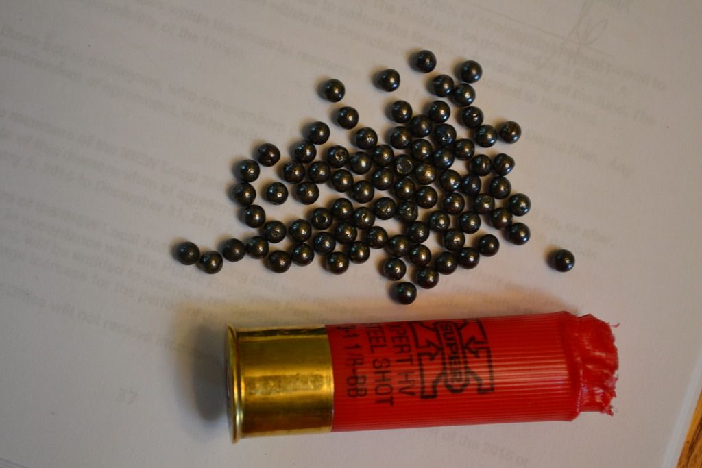

Win had 81 pellets that weighed 477 grains (1.09 oz) about half had noticeable pits in them. pics to follow

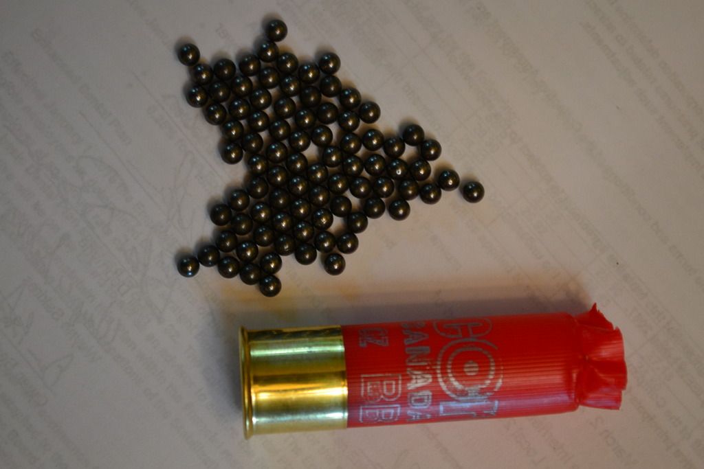

Score had 84 pellets that weighed 505 grains (1.15 oz) and look very consistent and round.

Conclusion: I had cronographed Winchester shells before and knew they were a little doggy in terms of speed and this confirmed it. I was disappointed the Score shell didn't pattern better, but when I have time I will pattern some more to make sure. I would have to think that the misshaped Winchester BB's would also bleed off speed a little quicker. I was rather impressed with the Score product considering you can buy them for $14 and they are made in Canada.
