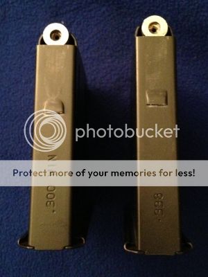

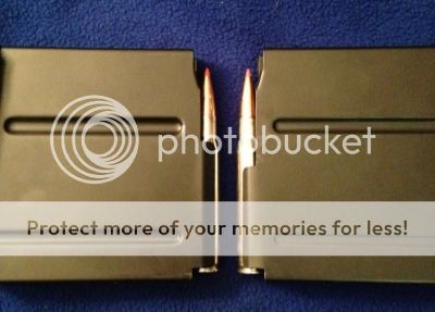

You can clearly see the difference in the feed lips between the 338 and 300 mags in this pic.
I’m not sure either is better at this moment; the 300 took a fair amount less bending to get it to work, but the 338 feels smoother.
