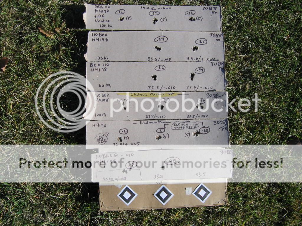

Here are some (not cherry picked) groups from the 30 BR I started shooting a couple of weeks ago. Counting only the eleven last FIVE SHOT groups @ 100Meters - the average is 0.29" C to C---best group 0.08". Gun pic to follow

The groups I counted (just the 5 shot groups) were all 110 Bergers...I don't have a chrony but with close to 34 gr of 4198 they should be going about 3000 fps out of the 24" barrel.
You will notice a couple of groups on the bottom two targets (left side) where I shot 3 shot groups with 125 Gr Bergers. Since not much load data on the 30BR, I was being consevative as I got to heavier bullets.
