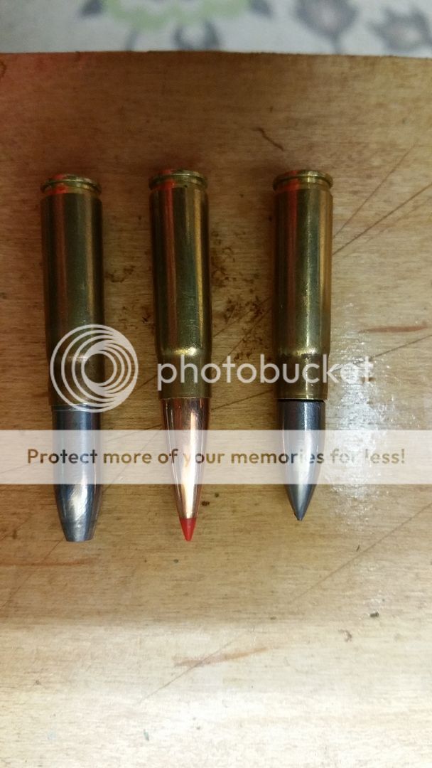

300 blackout 200gr lead whosa done it?
Noe 247g is the way to go
noebulletmolds.com/NV/product_info.php?cPath=30&products_id=207&osCsid=v9vcgjeglt0evg552nuo63cs62
if the nose will fit any cast 309-311 dia with 1-2 or 3 lube grouves with a shorter shank will work 150 to 247g the heaver bullet the better function
the longer shank (base) on some will engage the rifling and stop it from chambering
