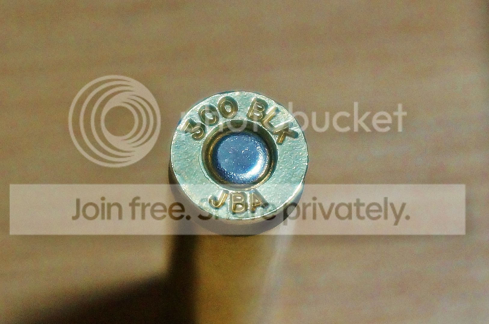

X-Reload had a sale on some items awhile back and I picked up some new JBA 300blk brass along with some .308 boolits from them at the time. I'll be converting my own eventually, as CR5 mentioned above, just wanted to start off on the right foot for my first 300blk handloads.
