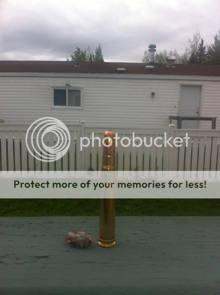

I went out hunting last night for my spring meat bear and much to my suprise I came across one that was hobbling and while further glassing I noticed it was only walking on 3 legs so I did the ethical thing and harvested it. Apon skinning the animal I was surprised to find my bullet just under the skin I was using my 375 H&H with 300gr federal blue box ammo when I took the shot. I was only about 150 meters away from it I wouldve thought it would"ve gone right through and kept trucking on. It was'nt a huge bear by any means but it did hit its back bone and then went through its ribs. I don't know if I should use them on moose now or load some up with a better bullet. whats your opinon? (oh and as for the bear and it's foot it looked as if someone shot it in the pad and broke its foot)

Speer doesn't make a 300 gr. round nose for the .375, nor a 175 gr RN for the 7x57. Check the photo posted by the OP and the bullet is identical to a Hornady round nose.
It's not impossible but I still doubt it. Bullet companies will make bullets for ammo companies that are not available to reloaders. I have a recovered 160gr 7mm Barnes TSX boat tail that I recovered from a moose. I was shooting Federal Vital Shock ammo. If you look at their website, Barnes doesn't make a 160gr 7mm TSX boat tail.
They sure look a lot like the Hornady round nose, identical ogive / meplat and length from cannelure it appears. Hotcors are pretty junky bullets mind you, so that's no improvement if it were the case, I think they're Hornady RN though. I had a 235gr hotcor act very badly on a Zebra, killed it but had me worried for a bit.
