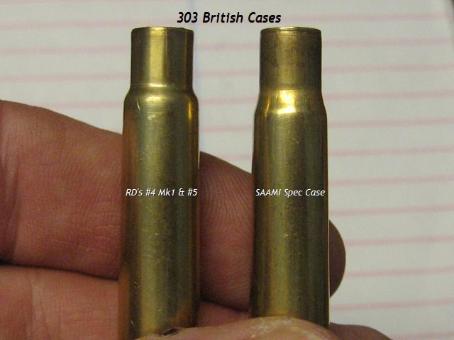

Below on the left is a .303 British case that was fired with reduced cast loads. The case did not stretch at reduced chamber pressures and only the primer backed out. And at low pressures, the primer will back out by the amount of head clearance your rifle has.

And from looking at the OPs photos I would say he has a standard .303 British military chamber.
