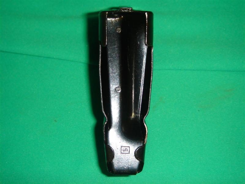

This is a No 4 mag but has a different follower than the other Enfield mags that I have. Anybody know anything about this style ? The mag body has a 22 stamped on the side.
Thanks,
REM
Magazine for a C No. 7. If someone needs one, its worth more than a LB No. 4 magazine in comparable condition.
Answer to the same question posed by a different poster last March ... :D

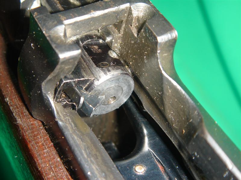

Savage (Enfield) .303 No.4 Mk1 Magazine
(Click PIC to Enlarge)

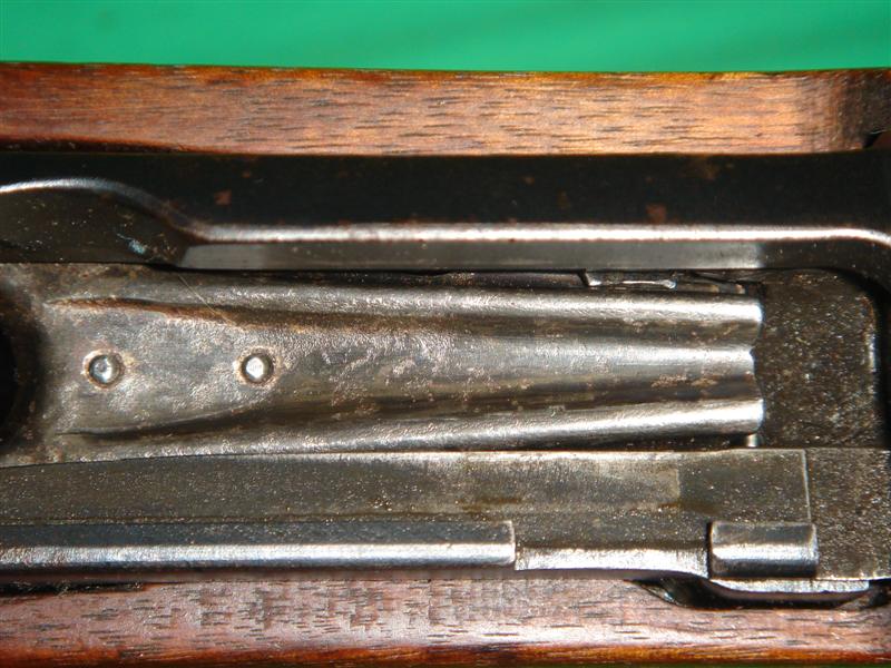

Long Branch C.No.7 Mk1 Magazine (.22 Caliber)
Notice the carved out slot at the rear of mag for the fired .22 casings to fall through into the magazine well itself. As tiriaq said, the mag is worth a few healthy bucks to a C. No.7 Mk1 .22 owner.
