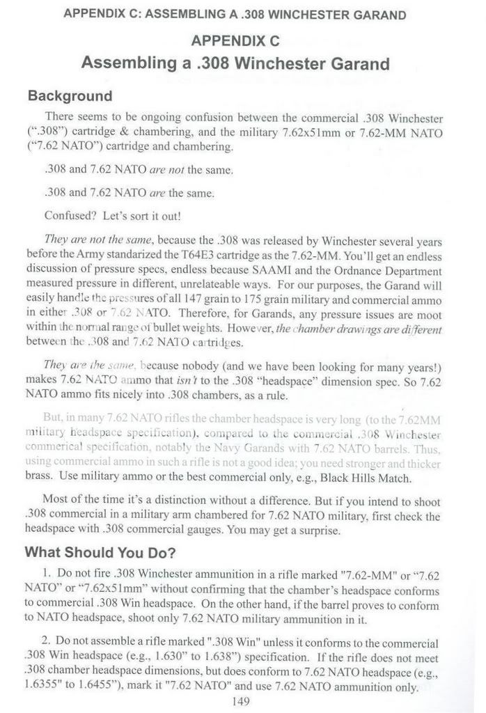

The rifle he has is supposed to be one of the last 500 ever made for the navy. It has some kind of US markings on it I believe,
If it is an original rebarelled M1 It should have a large 7.62 stamped on the receiver!
Be careful original 7.62 navy M1 a known to have long headspace for .308 commercial ammo as stated at the bottom of this page
