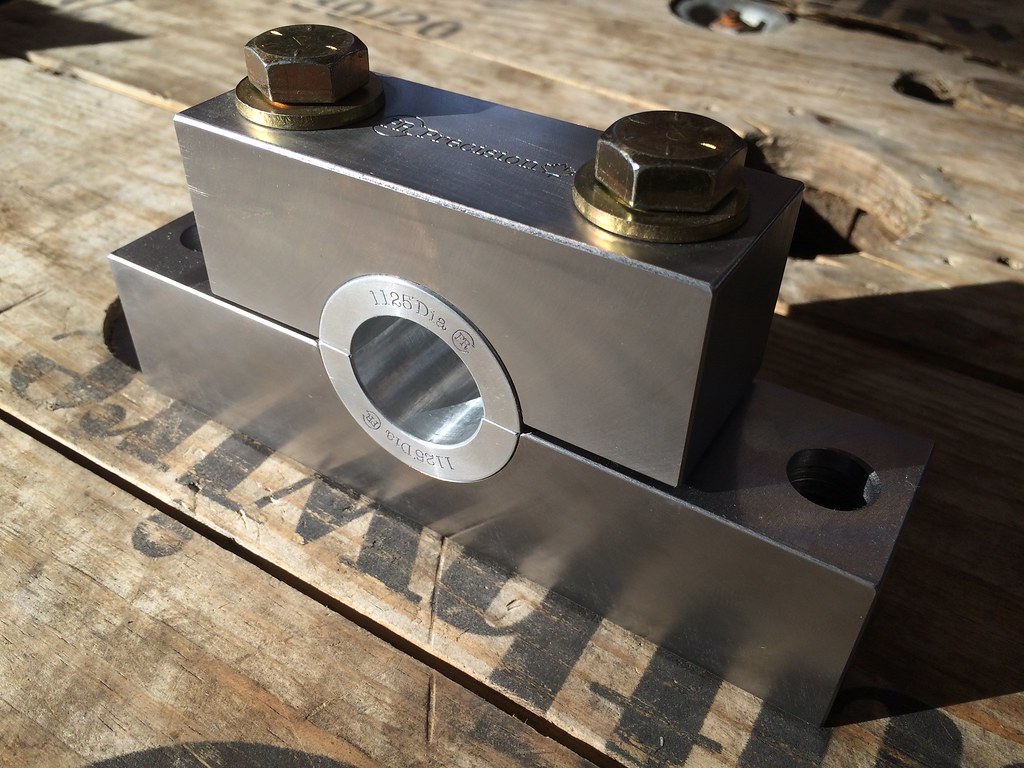

Purplecrow: Here's a picture showing what's going on.
The barrel is held in the vice with bushings that are machined to fit your contour (add a layer of printer paper to prevent aluminum "rubbing") and the receiver is held in the wrench (also machined to fit your make/model and wrapped in paper).
Give the wrench a hearty tug and it'll crack loose.

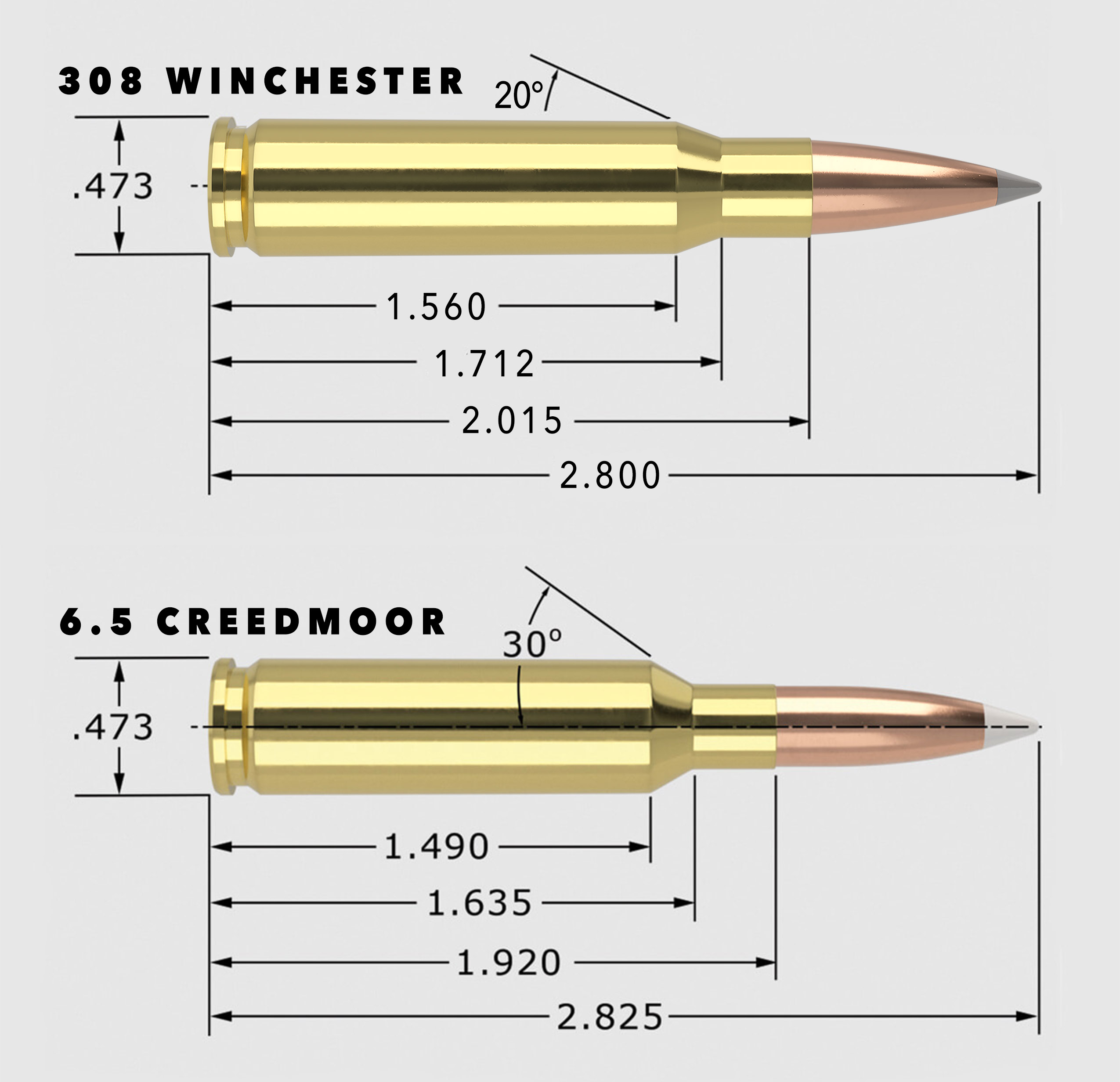

Here's a quick comparison:
As you can see the case heads have the same dimensions. So, yes, a barrel change only is usually required.
