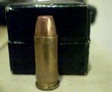

.32 Auto FMJ

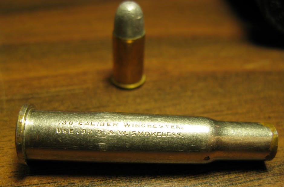

I miked the base end and it is showing .337" internal diameter. It must be later than I think because I miked the barrel end and caught myself saying,:" .308", now isn't that a coincidence.:rolleyes:
OD of base is .504".....Inside diameter of step is .382"
Your adapter is good because it takes .32 S+W (lead bullet), what's the use of the .32 acp ones for the .30/30, most factory .32 ACP ammo you are going to find is going to be fmj, useless for hunting in Canada pretty much. On the marlinownersforums a guy worked up a load with a .314 lead round ball, a .22lr case full of bullseye, apparently this fellow was getting pretty nice groups at 50 yards with this load in a Marlin 336 (.30/30), he was using buckshot so the most expensive part of the reload was the primer. I suppose the Hammond Game Getter is another good choice too, but the thing is unless you get more than one you are sort of restricted to a single shot but in the Hammond's favour, you can use rounds for a Powder Actuated tool, (although these are expensive) nothing fancy required except for the bullet (he recommends a lubed bullet with a gas check if you are using the heavy loads).
Being able to shoot 32ACP FMJ with an adapter...Cheap practice.

I've only used my 32ACP in 303BRIT adapter as cheap practice (read trigger control) and really to see how well it worked. The one I got is a Marbles (I think) and it took me a long time to find this one (just never know what's going to show up at gunshows). Just more fun stuff to fiddle around with.
