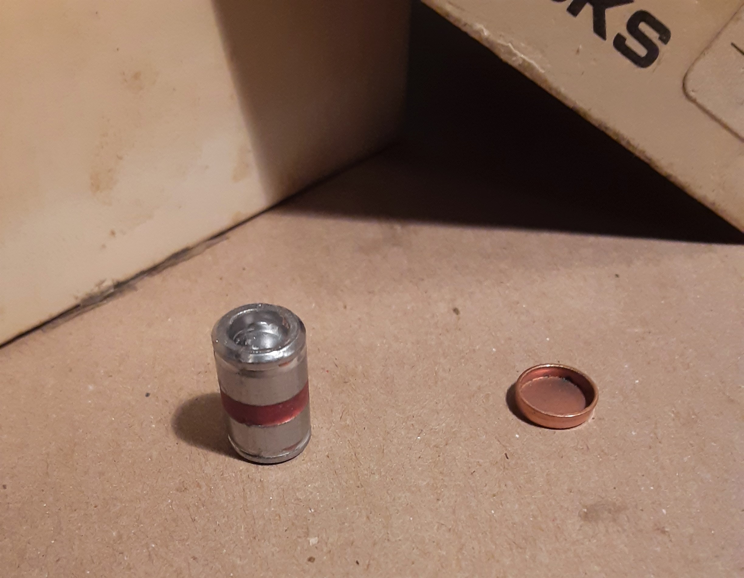

If you cast, and don't have a Wadcutter mold in 0.312"-0.314", but do have a mold that size with wide lube grooves, you can make your own using gas checks. Place a gas check upside down in one of the lube grooves and pour.

Hmm... Wonder if inverting the gas checks could be used as hollow bases? Would they stick to the lead?
You wouldn't be able to pour lead with gascheck in place, it would cover the hole at the top (unless mould is a top-pour design, which is not something you see often).
Sample of the R&R HBWC bought some years ago.
This is what I was thinking about with the gas checks to used them for a "hollow base".
You insert the gas check facing up in one of the lube grooves and pour as normal. You can see the bullet shape very clearly and with that mold there are several lube grooves from which to choose. Since that mold is for a gas check bullet, the front is "semi-wadcutter". A plain base bullet mold would create a "full-wadcutter".

"diopter's" idea is just that you have the gas check facing down instead. If the gas check was clean (use a bit of solder flux) I imagne it would stick well enough to remain attached to the bullet after firing. I find that gas checks used as I do remain as I have recovered several from the berm. They cut perfectly round holes in the paper of course.
My mistake, obviously I didn't get what he meant...
